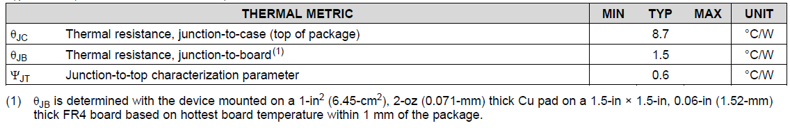

Please help to provide the thermal information of CSD95495QVM
  • Daniel,
    Thanks for posting.
    See below for the thermal table for this part:

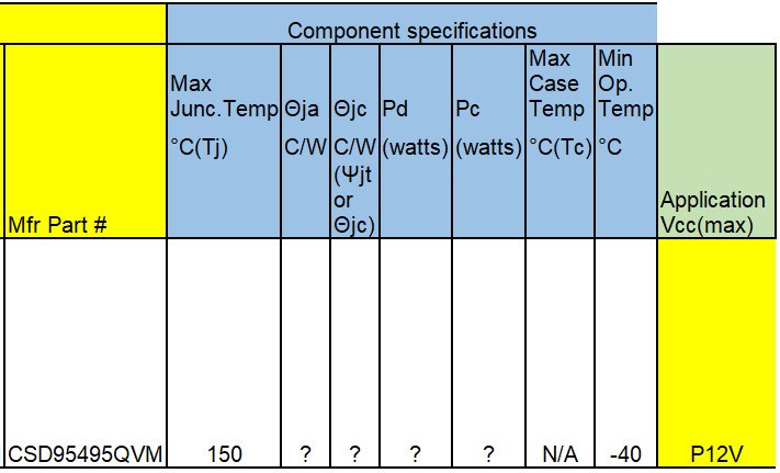

  • Hi Brett,
    Could you also help to provide Pc, Θja and Tc?
    Many Thanks
  • Daniel,
    I am not sure what you mean by Pc - do you mean how much power the device can dissipate? That would just be the Tmax - Tj divided by the thermal impedance.
    The RthJA thermal impedance is just as much if not more so a function of the board and the thermal environment the part is being used on than it is the package or die inside. For instance, on 1x1" 2oz Cu, this RthJA would be around ~40deg C / W. For a min Cu board, the RthJA could be as high as 100 - 125deg C / W.
    The max case temperature is the same as the max junction temperature if both are in equilibrium. However, if you are at this case temperature, you can not dissipate any power in the junction as it will heat up beyond the 150 abs max.

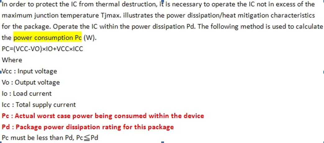

  • Dear Brett,
    Thanks for helping.
    Please teach me how to get Pc and Pd of CSD95495QVM? What parameters are necessary to calculate Pc and Pd. (Our application VIN is 12V.)
    Below is the explanation of Pc, Pd from customer. Please kindly help.
  • Daniel,
    Sorry for the delay.
    The amount of power you are dissipating in your application depends on many conditions - in the above example, they calculate using the input current, supply voltage, output voltage and output current.

    The max power (Pd) the customer can dissipate in the package is determined by the following : Pd = (Tj,max-Ta)/RthJA. As stated above, the RthJA is going to be specific to you customer's application. It could be as low as 40deg C / W or as high as 100deg C / W depending on the thermal environement of the end equipment.
    If I assume the Ta is 25deg, we would say Pd could vary from (150-125)/125 = 1W to (150-125)/40 = 3.1W.
