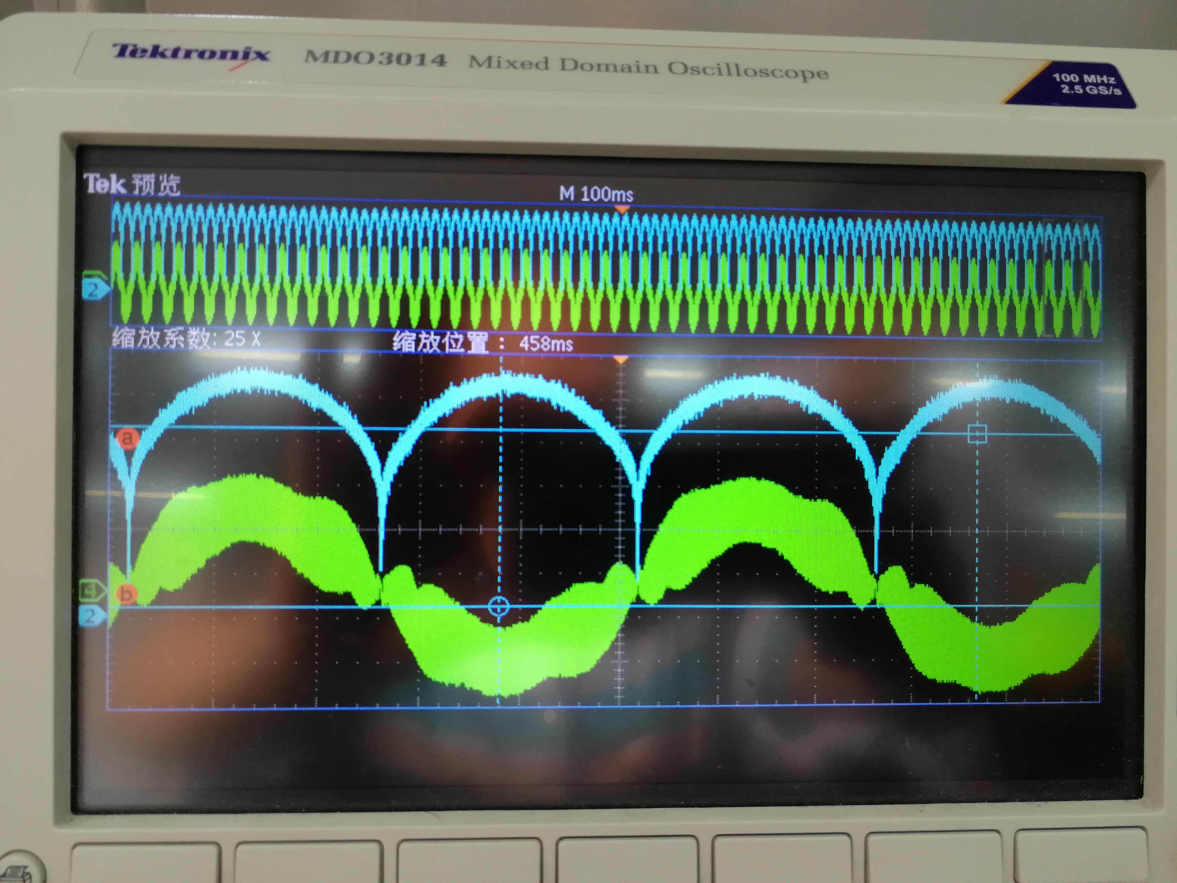

         I have a proble when i use UCC2818 as pfc control device,The wave profile is well,but the THD of current is bad, which is above 12%,Can you provide some method to improve the THD?
normally how well can do of the THD using ucc2818?
    Can you please quantify your results with some data?
    You will needs some of the following
    (1) Current waveform
    (2) Schematic with component values
    (3) Design requirements.
    You should plan on designing for a THD of 4% at full load at low line
    THD will get worse at lighter loads and with increasing line voltage.

  • some design requirements as follow:
    1.half of load,the thd is below 5%;
    2.pf is above 0.99 at the full load;
    3.the full load is 1000W, PFC inductor is 150u, the frequency is 120K,the vin is 220 Vrms
    some test waveform as follow:
    the IAC is 2 CH
    the current of inductor is 1CH
    the thd is 10% at full load, but thd is 8% at half load, the question is  the higher of thd,the the heavier of load

  • Hello ,
    The fact that THD gets worse with increasing load is interesting. Normally THD and pf get better as load is increased.
    I would reccomend that you look at two things:
    (1) The value of the film capacitor on the DC side of the bridge is chosen at the full power rating.. This optimized THD at full load and makes THD lower at fractional loads. This is because the cap is not full discharged at lower loads and results in a capacitive type of loading on the AC input.
    Please look at increasing this cap value and check for improving THD at high power.
    (2) The UCC2818 comes with a Mathcad calculator. I ran the calculator for a 1000W load and 120kHz switching frequency. The results are attached in pdf form.Calc_res.pdf
    Please check the results and look for any differences between the calculator and your circuit.
    (3) Please look at the current waveform (CH 4) in greater detail.
    Is this the input current or the inductor current ?
    What does the switching waveform look like with a time base of 10uS/ div ?
    There seems to be a lot of ripple on CH 4 and I suspect that the value of cap referenced above is too low.
