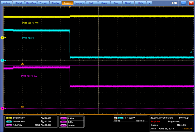

Hi TI,
We found there is a 40mV at TPS51200 Vout after OCP and SCP test. I didn't find any test waveform in datasheet or EVM document.
Looks like the controller still working and limits Iout at 50% current limit level then the power dissipation would be (1.2V-0.04V)*2A=2.32W?
Is it acceptable or just my misunderstanding? If it's acceptable, what's the theory? And how could we make sure the controller is without power / thermal risk at such condition?
