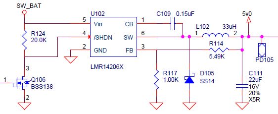

LMR14206: Soft Start requirement
Part Number: LMR14206
I am using LMR14206XMK/NOPB in our design. I analyse the inrush requirement for my design. I am driving the /SHDN pin as in the below schematic. Could you please let me know that how to calculate the rise time/start up time of the output voltage for my circuit? Because I couldn't get the answer from the datasheet.
SW_BAT - 8V-12V
