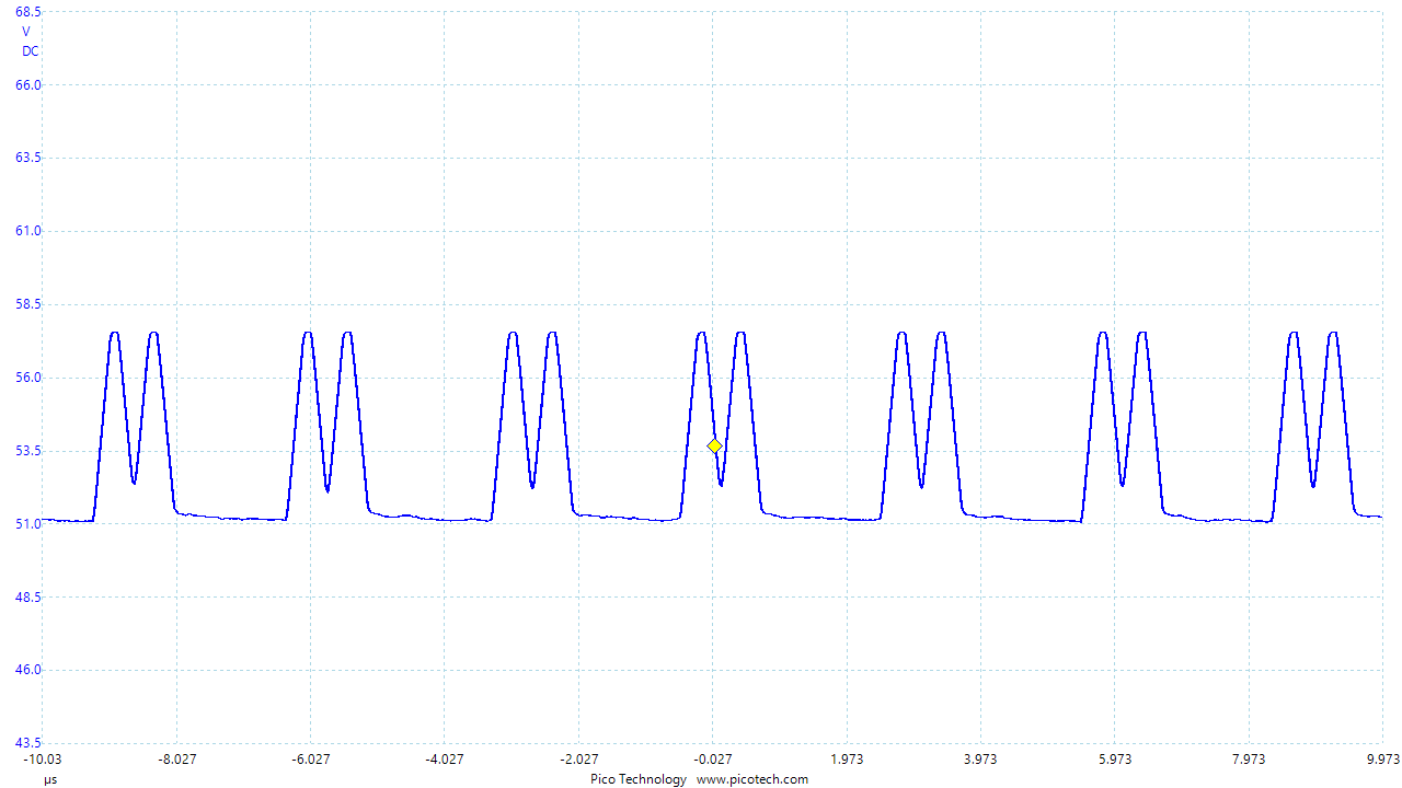

Here is a picture of the PMOS gate signal from the LM3409HV:

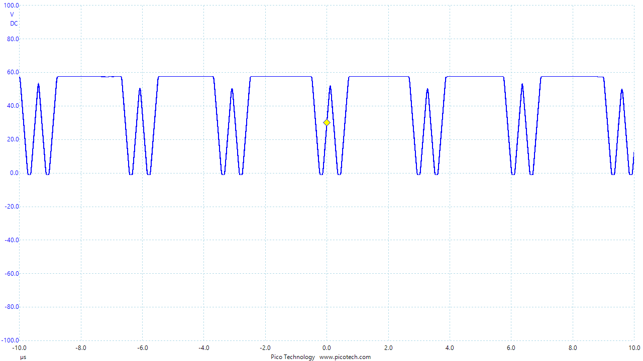

Here is the input to the 330 uH inductor:
You can see that the gate is charging and then shutting off. Making Ton vary greatly. This causes the part to be running at twice the frequency, taking a lot of energy to charge the gate, and then not actually accomplish much half the time.
I understand that noise can cause this. What else can cause this and how can I get control over this behavior and get the part to generate more predictable outputs?

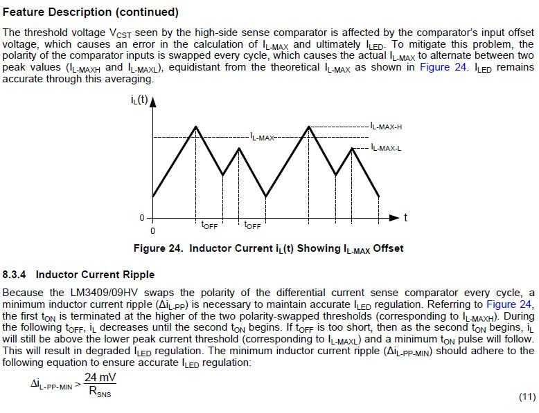

  • Hello Brian,
    Is your ripple current very low?
  • Thanks Irwin.
    I was just reading through the documentation and just happened to be reading this section when I got your post notification. I was on the right track...
    I am trying to keep the ripple current very low. Suddenly this makes sense. With a 0.22 Ohm sense resistor I have to keep the ripple current above 110 mA in order to steer clear of this behavior. But I need linear behavior down to 100 mA, putting the two qualities at odds with each other.
    To get 1 Amp average current I need a lower sense resistor, to get CCM behavior down to my desired 100 mA, I need a higher sense resistor.
    I have to redo my spread sheet with this knowledge and see what I can come up with.
