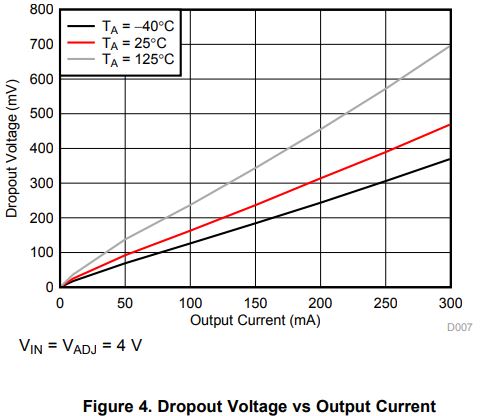

Although Fig.4 and Fig.5 shows Vdrop, it's the case of Vin=Vadj=4V.
In addition, though 6.5 shows max Vdropout=520mV, it's the case of Vin=Vadj>4V.

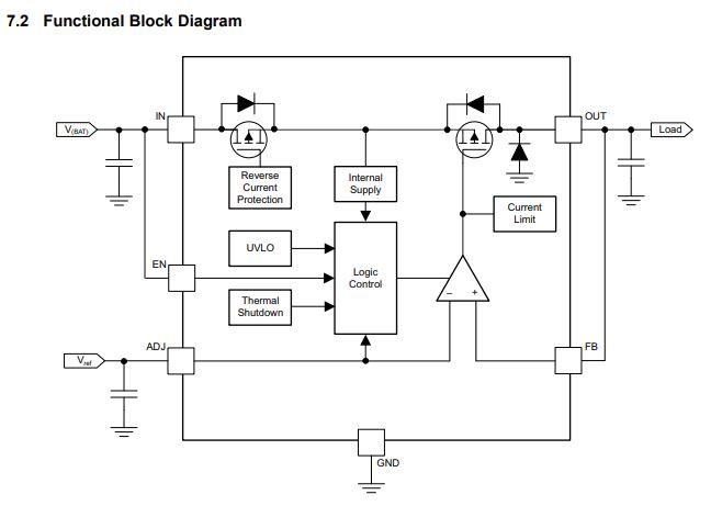

  • Hi Shota,
    The test conditions of Vin = Vadj are used in order to force dropout.  TPS7B4253-Q1 operates in unity gain as shown in the functional block diagram, so in order to force the device into dropout in order to measure the voltage drop between Vin and Vout (dropout), Vin is set to Vadj.
    As Figure 4 shows, dropout is linear on TPS7B4253-Q1 with respect to current; therefore, we can calculate the maximum dropout at 100 mA by setting up a ratio:
    Vdomax100 / 100 mA = Vdomax / 200 mA
    Vdomax100 = (520 mV / 200 mA) * 100 mA
    Vdomax100 = 260 mV
    With our calculated maximum dropout you can see that your minimum headroom of 1 V is plenty to keep the output within regulation.

  • Hi Ryan-san,
    Thanks for your detail answer.
    Just for making sure, when output current is 100mA, the dropout voltage will be 260mV regardless of input voltage.
    Because dropout voltage is 260mV at unity gain.
    Is this my understanding correct?
    Shota Mago
  • Hi Mago-san,
    Dropout is a measure of how much headroom (Vin - Vout) is required to maintain a regulated output. As such with a 100 mA load, your input voltage must be 260 mV higher than your output voltage in order to maintain regulation.
    In your application your input voltage is 1 V higher than your output voltage at the lowest Vin. As such your application should maintain regulation.
