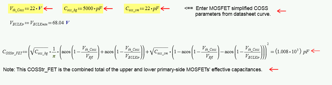

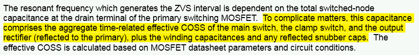

I was trying to calculate switch node capacitance and I have few questions.
I found in the MathCAD sheet the list of capacitances which I need to consider as shown below:

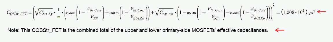

It is followed by one formula as shown:
1. Can I get some kind of derivation of this formula?
2. Is this effective time-related capacitance?

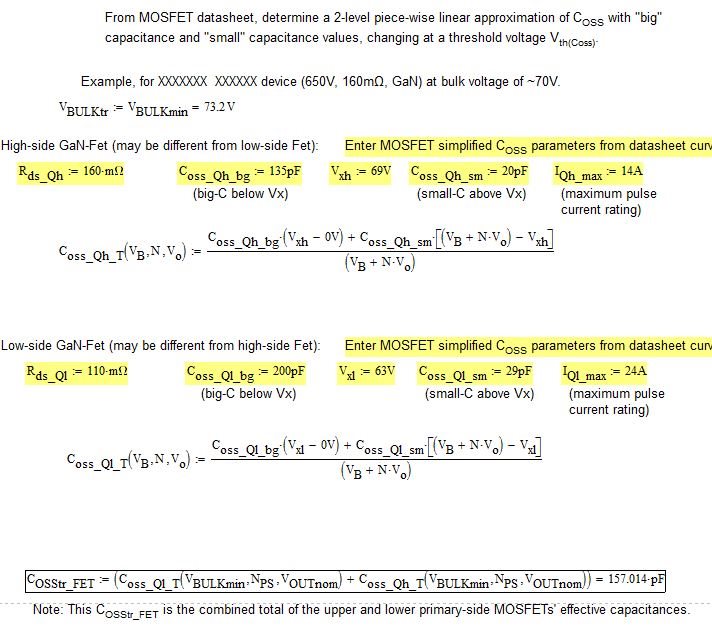

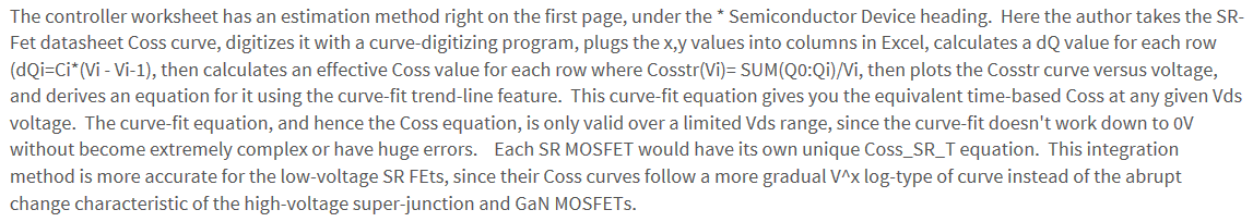

3. If it is Time related capacitance, is it also calculated by the same procedure as explained by Mr. Goerte in reply to one post named “UCC28780: More questions about MathCAD worksheets”?
Mr. Goerke explains :
4. Coss for depletion mode MOSFET should also be calculated with the same procedure as shown above?
In the same post, Mr. Goerke suggests one way to find capacitance of primary MOSFETs individually as shown below:
I tried to calculate primary MOSFET Coss with both the formulae (As given in MathCAD sheet and as suggested by Mr. Goerke) but I got different results.
I selected MOSFET - Infineon IPP60R180C7
Vbulk_min - 68.04V
Nps – 8
Vo_nom – 12V
Vrfl – 96V
With the formula in Mathcad sheet, I got, 1.008*10^3 pF
With the formula suggested by Mr. Goerke, I got, 1.379*10^3 pF.
5. What could be the reason for different results?

    1.The derivation is quite complex, I will contact the designer and feedback to you.
    2.Yes. It is the time-related capacitance.
    3.Yes, it is the same procedure, but slightly different concept which cause slightly difference of your calculate result.
    4.Because the depletion mode MOSFET have quite small capacitance, so it is not worthy to calculate it by time-related.
    5.The equation use slightly different concept, which cause have different input parameter.
    We will suggest you follow the equation:
