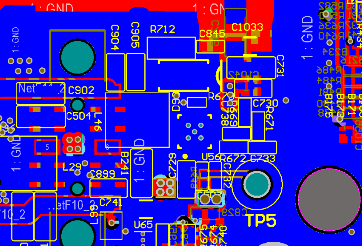

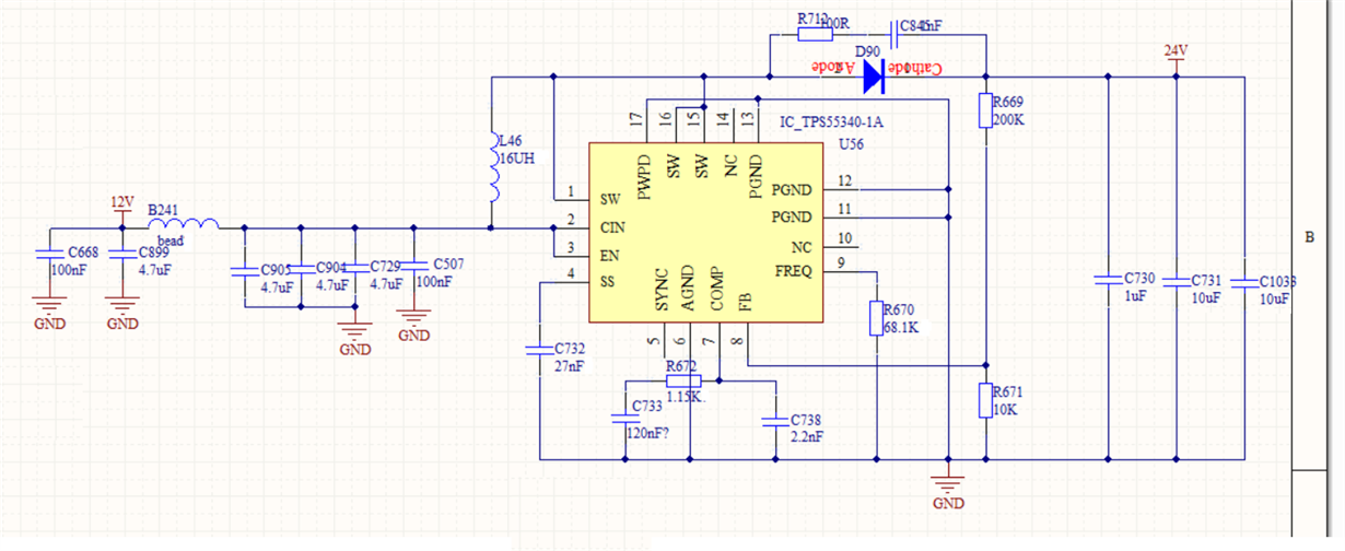

I use tps55340 for boost  Circuit.
Input voltage: 12V  ; Output voltage: 24v  Iout=1.5A(max)
I do test about the basic function, it,s OK. But the reduction Beyond the limit.
so i reduce the switch frequency, But it seems not work.
thanks very much.
Schematic  for Webench,  Something need to be improved or not?
BOT: INPUT Cap not close to the IC.
