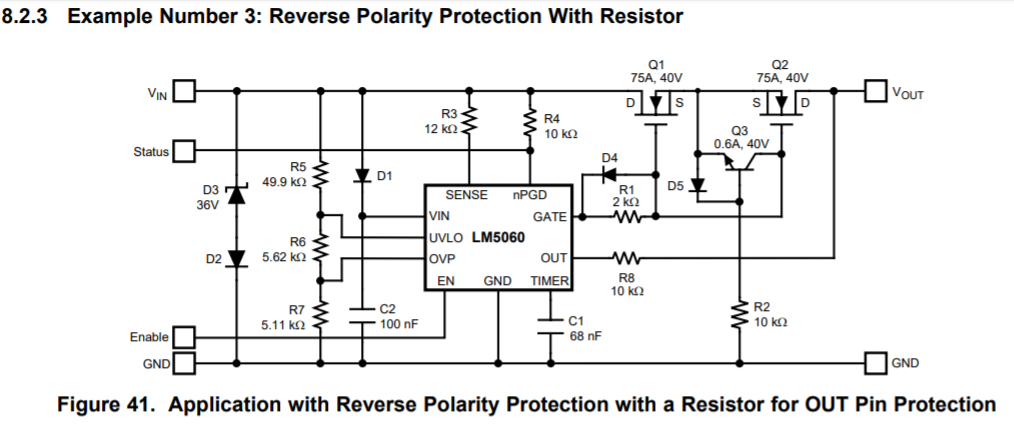

3. Having only Transil/TVS/Transorb Zener in parallel to battery may not be sufficient as eventually external fuse will blow. Hence, do you have a design suggestion to develop 24v,15-20A power supply for high side driver with minimum BOM and size with following features.
- Reverse polarity protection
- Automative load dump protection.
- E-fuse with 33V max and 15-20A max. [ So that external fuse do not blow ].
