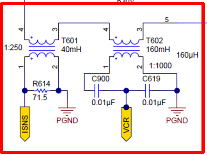

Hi all,
I want to configure the Full Bridge LLC by using one UCC256303.
How to sense   VCR and ISENS ?
Capacitor divided sense method cannot be used for Full bridge LLC configuration.
Please give me both detail cct. for two method.
One is using CT (Current trans)
Another is using AMC1301 (ISO current opamp)
