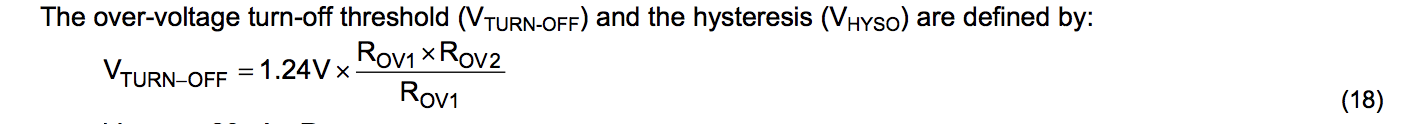

On the datasheet, it looks like equation 18 and equation 20 on pages 15 and 16 on the datasheet are incorrect. Can you verify that it's supposed to be Vturn-off = 1.24*(R_ov1+Rov2)/Rov1 for equation 18 and Vturn-on=1.24*(Ruv1+Ruv2)/Ruv1 for equation 20? Unless I'm missing something big here?
