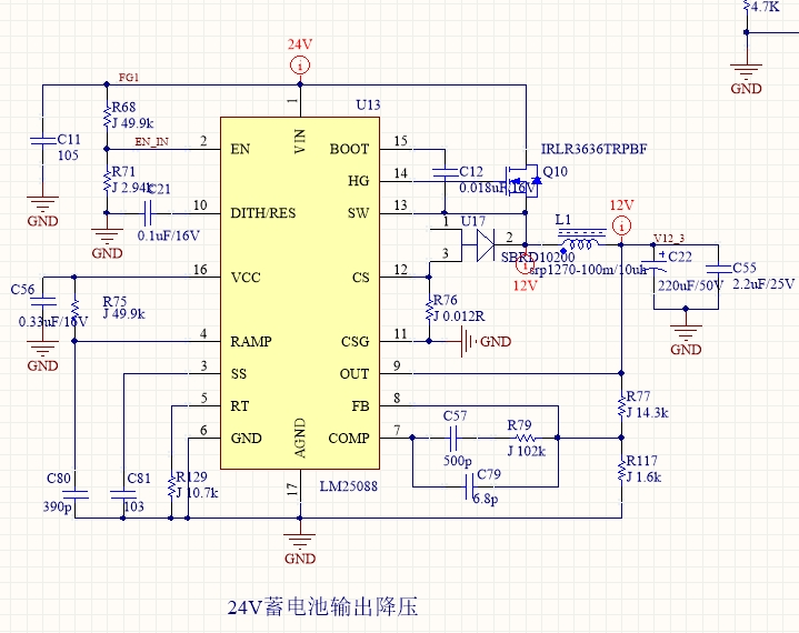

LM25088: If add load, LM25088 output would be drop
Part Number: LM25088
Dear TI:
    My customer use LM25088, Vin=24V, Vout=12V, when no load, the output is 12V,  but when there is 1A load, the output would be drop to 9V, and when the load increase, the voltage drop more big.
    Can you help to analyze the LM25088 problem? Thanks!
