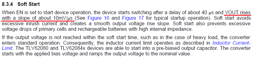

Hi Team,
My customer considers to use TLV62084 however ramp time (10mV/us) is faster in his application.
Is there any device that has slower ramp time in start-up?
I heard 5mV/us is ideal in his application.
(datasheet Page 10)
The application requires 5Vin, 3.3Vout / 650mA(max) and same package (8 pin WSON) is ideal.
