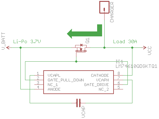

I want to ask about using LM74610-Q1 together with Lipo Battery Charger.
I need LM74610-Q1 for protecting from reverse battery polarity because it's replaceable Battery, and also can be charge via USB.
V_BATT Li-PO 3.7V & VCC is load with 30A max.
Because I can't find any reference for connecting charger with LM74610-Q1.
So, what I need to ask is.
Are the battery can be charging when connecting charger connection at Drain of mosfet?
Or any available TI Linear battery charger that have reverse battery protection? so I can connect the charger at Source of Mosfet.
Here is the simple schematic:
