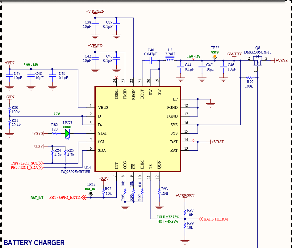

BQ25895M: Battery voltage read is 0 when not charging even though the battery is not depleted yet.
Part Number: BQ25895M
Other Parts Discussed in Thread: EV2400
I have set the battery chip to host mode and ADC conversion type to continuous 1s.
I have checked that I got ACK from the bq25895M as well.
I can read battery voltage using my C++ program when the battery is charging, but I receive 0 as soon as I stop charging the battery.
I don't understand why and how to fix this problem. Do I need to set anything else?
Any helps would be appreciated.
Thanks.
  • What is the expected battery voltage?
    There is a limitation that BAT voltage needs to be about SYS_MIN setup.
    Thanks for your answer.
    The BAT should be about 4.1V which is greater than SYS_MIN which is 3.5V. When I stop charging, BAT goes back to the default value which is 2.304 V.

  • Could you please provide all the register values? Thanks!
  • Hi Ning,
    Sorry for the late reply. This is all the register values.
    Thanks.
  • The register values provided do not show BAT ADC reads 2.304V. Based on the register values, REG0E[6:0](i.e.BAT)=45(HEX), i.e. 3.684V, REG0F[6:0](i.e.SYS)=45(HEX), i.e. 3.684V and charge state REG0B[4:3]=00 (i.e. not charging). These readings look normal. I have translated the register values to HEX values. You may plug in the attached register txt file into the bq2589x GUI by "load Registers" and confirm the BAT ADC readout. Thanks!

  • Hi Ning,
    Thanks for the answer.
    I have tested and confirmed that VBAT value when not charging is correct. It is not the case with charging.
    When the battery is charging, the VBAT does not reflect the true voltage of the battery. Particularly, when charging the VBAT can read 4.1V, and VBAT right away be 2.304V when unplugging from the charger. Moreover, the VBAT can go above the maximum voltage that it has which is 4.2V.
    I can read the VBAT correctly when charging if I use EV2300 and bq25895MEVM_664. I just can't read it correctly when debugging using bq25895M board.
    Is there any settings that I need to set for bq25895M to read the VBAT correctly when charging? Such as a setting to stop charging when reading the voltage.
    Thanks.
  • We have to duplicate the behavior your mentioned in order to understand and resolve it. Could you please try to duplicate the behavior on the bq25895M EVM with EV2300 or EV2400 and let us know the detailed test procedure to duplicate the behavior you described? Thanks!
