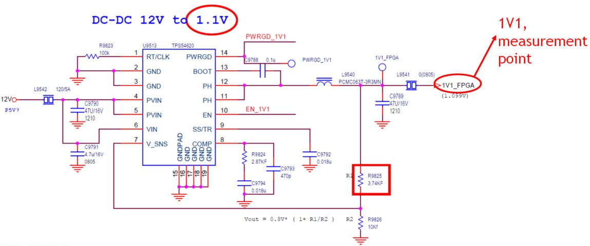

Hi Team,

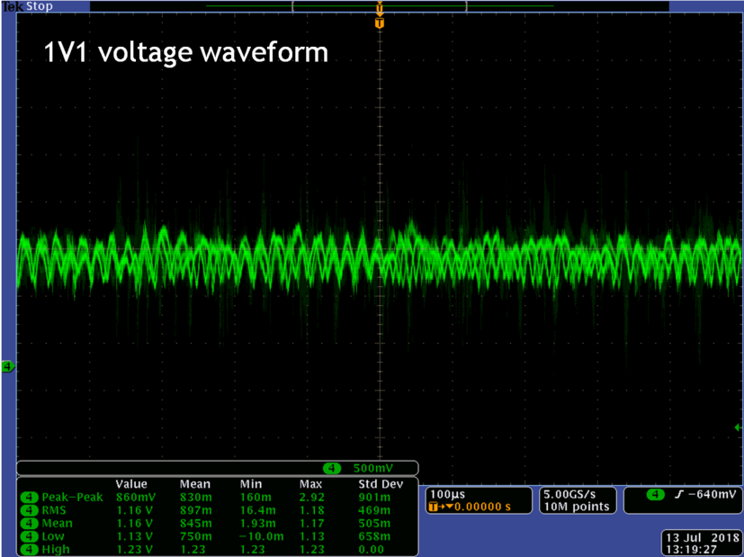

My customer is using TPS54620 at 12V to 1.1V application. He encountered output voltage is randomly unstable issue.
1. Below is customer's SCH.
2. Below is the unstable voltage waveform.
Usually, it happens at power up at room temperature, once the device get warm and customer reset TPS54620 by pulling down then pulling up EN pin, output voltage become normal.
If output voltage is stable, using freeze spray to cool down the chip that can reproduce voltage unstable problem.
Could team help to review the SCH and this issue, then please provide us the comment. If need any other information or experiment, please let me know.
