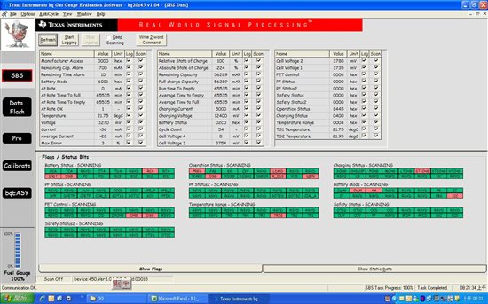

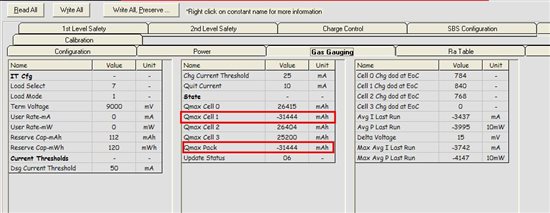

When used 54 cycle Qmax cell 1 from 26500mAh change to -31444 mAh. use EV2300 read data flash.
Then FCC change to 56289mAh. (Read SBS)
I don't know why, Please help me.
