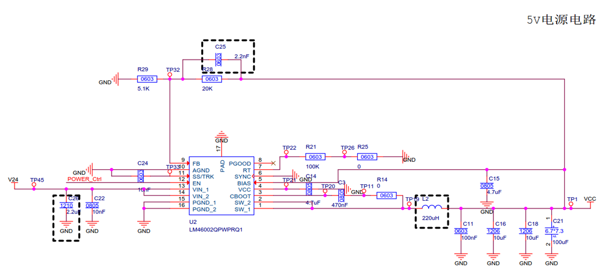

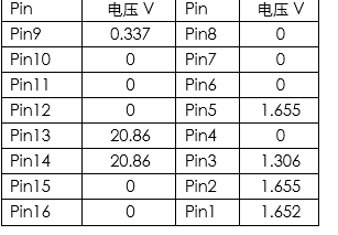

When i only provide 24V input and didn't enable ti ,i found Vout has 1.7V voltage. Dose it normal output?
This moment every pin output voltage as below
my schematic as below ,pls help to check my design

When you power up VIN, could you check the SW node waveform and see if there is any switching action in there while your EN pin is low?
Is there a way to isolate the output of LM46002 from other circuitry to prevent any back feeding from other peripheral?
