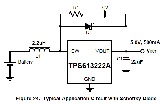

Regarding to conditions on TPS613222A, my customer is asking a question.
(Question)
They will design it with following conditions.
・Input: 3.6V to 4.3V
・Output:5.0V / 0.5A
(SW current 0.87A max @80% efficiency)
In case of above conditions,
Is there any no problem about operation?
I tried WEBECH for simulation but input range is up to 2V.
