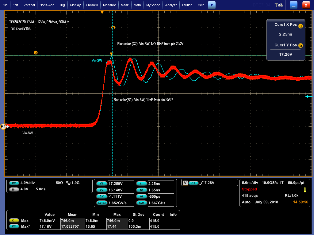

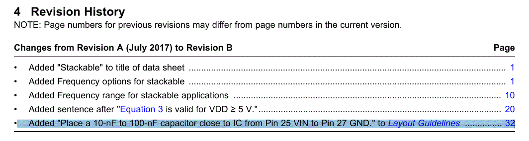

In PCN of TPS543B20 (Rev. A → Rev. B), it was added that the capacitor fromo Pin 25 (VIN) to Pin 27 (GND) is recommended.
Why is it recommended to add this capacitor?
What are the merits of adding this capacitor?

What I would like to know is why it is recommended to add it to Pin 25-27 (PVIN - GND).
If it is for "reducing the Vds of the high side FET ringing during turn off", I think it is normal to add it to Pin 21 - 20 (PVIN - PGND).
Please tell me about this reason.

Hi John-san,
I'm sorry for your bothering you again.
Why will not you check if the additional capacitor is Pin 25-27?
If you want to reduce ringing, I think that between PVIN and PGND is a reasonable place to add.
