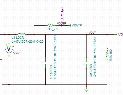

    Thanks for looking that over so quick for me and finding the errors I had.  At the times you set, the part does seem to work as needed, but the part itself doesn't actually seem to be regulating.  The output seems to go to 120V only because the output caps are set to 120V.  If I set them to 50V, 150V, 200V or 1000V the output goes to that value.  Also, I changed the load to 16 ohms to match my worst case output and the supply will just degrade toward 0V after the initial spike to whatever the output caps are set too.  Attached is your file with the output caps set to 200V and at 16 ohms load so you can see what I am seeing.  Do you think the issue is the transformer or the feedback network or something else.  I am assuming I calculated something wrong but I am not sure where to start looking, I must be making a flawed assumption some place that is throwing off my calculations.

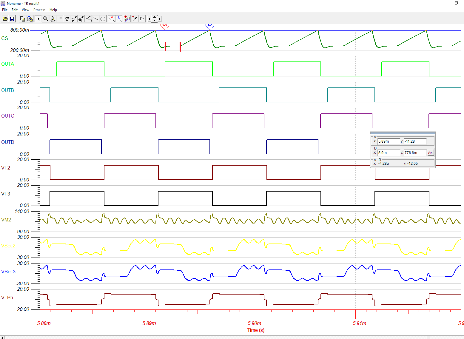

    I haven't fully debugged the sim, there is still a significant high frequency oscillation on the transformer waveforms. However there is an error on the VOUTTP test point - it should connect to the output side of the output inductor (L1) not the input side - modified version below
    I'll work on the HF oscillation next to see what is driving it and how to 'fix' it.

  • Colin,
    Thanks again for all the help, I moved the feedback path to after L1.  After I moved that I played around with the output capacitor, output inductor, transformer turns ratio and the feedback divider, nothing seems to get the simulation to behave any differently.  Could there be an issue with the UCC28950 spice model?

  • Hi Dan
    I'll check it out for sure. Certainly I saw the EA- input drop below the EA+ which was at 2.5V - I thought that was just because I did not let the sim run long enough. And there is still the issue of the HF oscillation on the transformer. I may be able to get to look at it tomorrow - I'm afraid I cannot get to it today

  • Hi Dan
    I replaced the MOSFETs with voltage controlled switches that I can drive directly from the OUTx signals - this eliminates a lot of potential issues with the MOSFET models, gate driver transformer and gate driver ICs. I've also dropped Vin to 10V so that the system should run out to Dmax.
    I'm seeing  a delay between putting Volts on the transformer primary and the primary current rising (CS signal) - the time between the solid thick red markers below. I don't know why this should be there - I also reduced the shim inductor to 2uH.
    Anyhow, I think the next exercise would be to put in a current monitor instead of the CT - it will be tomorrow before I can get to that.
