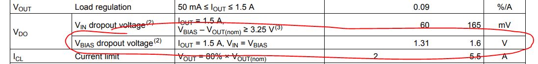

Customer would like to confirm if it is OK that Vbias connects to Vin 3.3V for Vout 2.5V application?
Randy Chen
Randy Chen
Hi Randy,
A Vbias of 3.3 V will not meet the Vbias dropout requirement for regulation for a 2.5 V output. As such you will be in dropout rather than have a regulated output. It is recommended that Vbias be at least 1.6 V higher than Vout in order to ensure that you have enough headroom for regulation.
