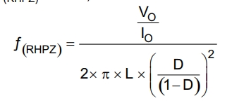

Q2: There are two type of Frhpz equation.
          Equation 30 is for Boost. (left)
          Equation 54 is for SEPIC. (right)
Why these are different? Our customer measured the frequency specification at SEPIC configuration.The result was same as the point which is calculated by equation 30.

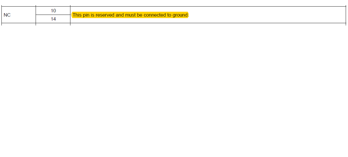

Q3: Regarding NS pin, Pin #10 and #14 must be connected to ground as it mentioned at datasheet.Our cusomter would like these pin to be open. Because they are concerned the case when the neighboring pin shorted.
Is there any concerned when these pin are left open? Or if these pin are shorted to the neighboring pin, does the device break?

    For Q1:  there's a weak relationship, but if you keep Ipeak<5.25 A, then it will be OK in any duty cycle;

    Regarding Q2, I calculated the value by each equation. However the result of Frhpz is different between equation (30) and (54). Why is the result different?
    Regarding Q3, I understood that NC pin should be connected to ground.However we need to explain to the customer.(Because it may couple some noise if left open.)
    Where is NC pin connected to internally? NC pin is connected to the ground of the die chip?

    for Q2: sorry I made a mistake. the right half plane zero of boost and sepic calculation is different. So what is the usage in your application, boost or Sepic?
    for Q3: The NC pin's max voltage should be controlled below 3V, or it will be damaged. So connect to PGND can for sure it is safe while left open may couple a certain level of noise and has the potential risk of higher than 3V.

    For Q2: The customer use this device for SEPIC. And they measured the Frhpz at SEPIC configuration. At the result, the right-half-plane zero is appeared at same as the point which is calculated by boost equation. So that is why we ask the difference of the both equation.
    For Q3: Damaged if the voltage of NC pin exceed 3V? Is there any note or warning at datasheet?
    The our customer's application is for automotive. They are cosidering about the abnormal case such as pin FMEA.

    For Q3: Please check the information below. Generally floating will not cause any problem but be better connect to GND. We can send the FMEA to you if you needed.

    >>For Q2: its strange. what is the Vin, Vo, Io, inductor L , output capacitance Co in the application? what is the test result, I'll double check it later on.
    Regarding this , we got the condition.
    Vi=2.5V, Vo=7.9V, Io=0.6A, L=4.7uH, Co=57uF. SEPIC topology
    Could you provide us Frhpz for the above condition?
    Koji Hamamoto
  • Hi Koji-San,
    My calculation result is fzRHP=89.3k based on the boost; and fzRHP=95.6k based on the Sepic topology. So actually the result is very near. It is hard to determine the exact the  fzRHP by test, it can be around a value, but will not be so precise.
