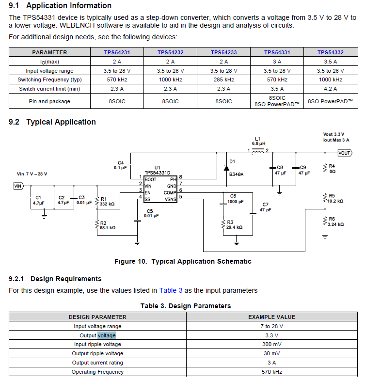

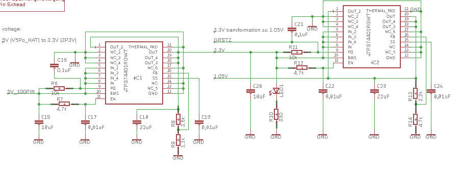

i build an PCIe carrier boiard for the UP-Core there I build my Platine with this Setting:
the Setting works but the first TPS74401 crashed after a short time and was very hot. After a short discussion I would like to use a current stronger component there.
So i searched for the TPS54331 but the Setting says that i could only use it with 7-28V. What components must I Change to use it with 5V ?
thank you for all
