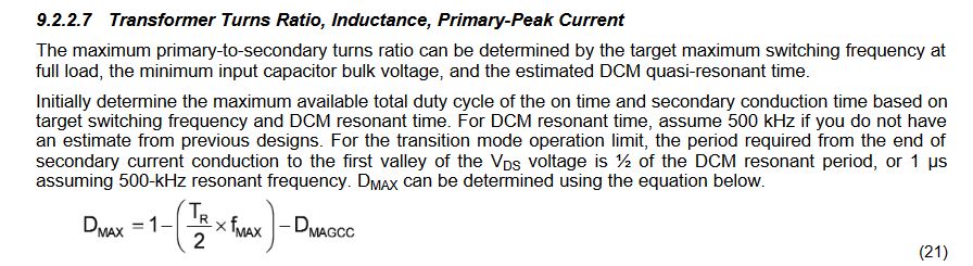

I have a couple questions on a formula in the UCC28700/701/7022/703 datasheet, Page 20, Section 9.2.2.7 shown below.
1)  How do you determine Fmax?
2)  Is Tr 1 uS or 2 uS?
I see discussion of assuming 500 kHz resonant frequency and therefore 1/2 of the DCM resonant period or 1 uS.  Since I'm not clear on this, it appeared maybe Tr was the DCM resonant period and the formula took care of dividing this in half (Tr/2 x fmax)
Thank you very much!
