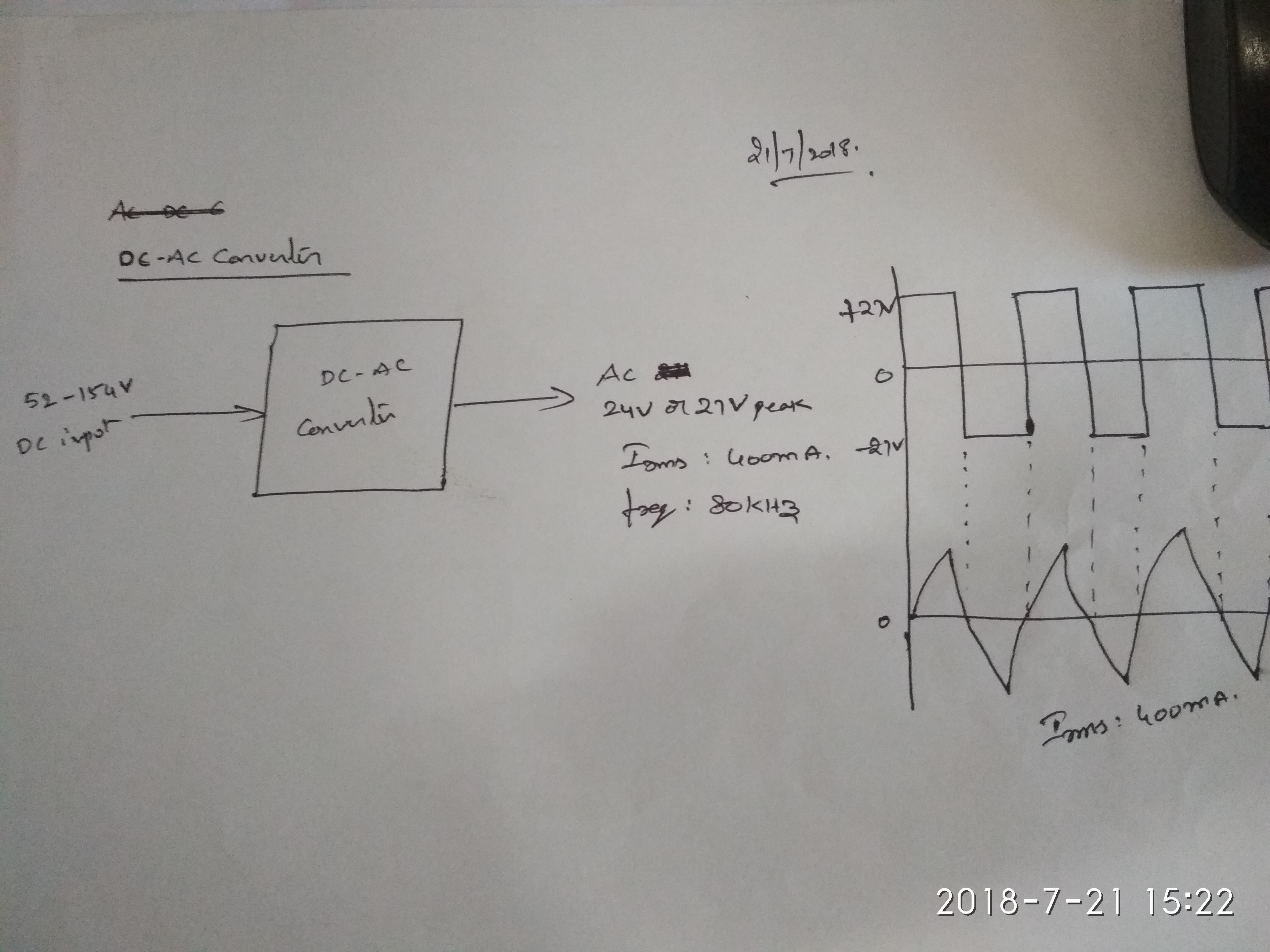

We have to design DC-AC Converter as per below specifications
1. Input: 52-154VDC
2. Output: AC 24V, 80KHz

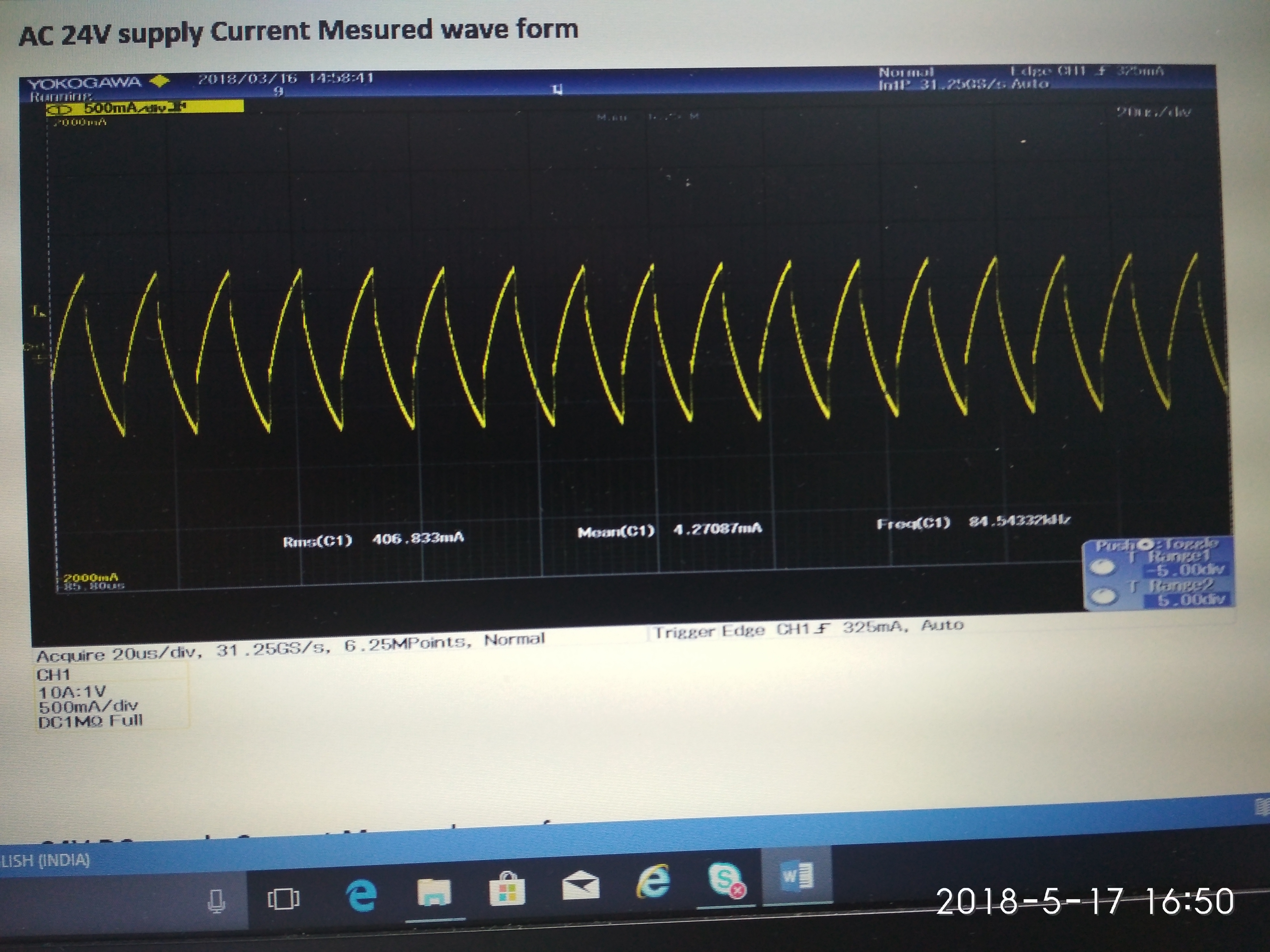

Output current current should be as per attached image.
Please suggest us any design /IC/ Circuit/ topology?

  • Hi Mr. Joe Leisten,
    Thanks for your reply.
    It is not resistive load.
    Output will directly connect to transformer primary.
    And yes, output current shape is very important.
    Output voltage may be 24V peak pulses.
    My requirement is as per attached image
