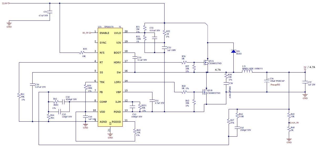

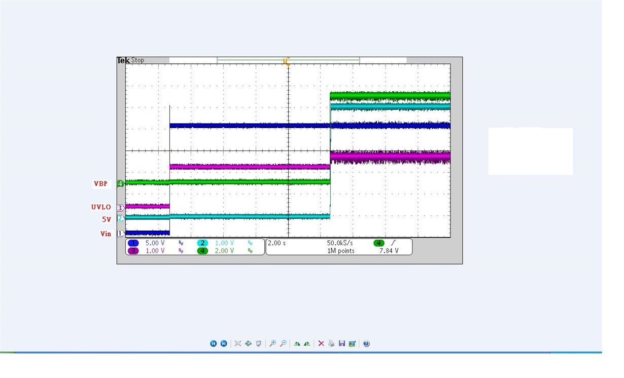

output waveform when under -10 degree condition , the 5V output & VBP will latter than UVLO about 5 sec more. Is that relative about low temp environment could cause output delay?
schematic as following

  • Hi Sam:
    1. 5 sec only will happened in low-temp condition only
    2.  customer try to connect UVLO & VBP directly, than no delay for 5V output
    3. We've an test waveform for EN & SW pin (@ low-temp) as attached.
    4. currently COMP pin value would be 3.83K ohm, 8200pF, 220pF (normal temp is OK for this set-up)

    3. Your UVLO divider should yield ~1.2V on UVLO but the scope captures show ~1.7V. Is the schematic up-to-date or maybe you're testing at higher VIN.
    -Sam

    Have they tried changing the values of the UVLO divider? Instead of 2M and 100K they can try 200K and 10K.
    I'd like to clarify Q1. If you measure startup time at T=-10C, -9C, -8C, -7C... does the 5 sec startup go away immediately (5s, 5s, 5s, 0s, 0s...) or gradually (5s, 5s, 5s, 4s, 3s, 2s, 1s, 0s, 0s...)?

    1.  RD  try to connect UVLO & VBP pin together, than 5V output won't be delay
    2. 5sec startup and go away immediately at -10C chamber (refer attached waveform)

    In the meantime, please change R51 and R53 to 200k and 10k instead of 2M and 100k. That will rule out if UVLO is the issue.
