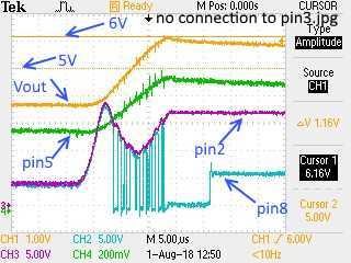

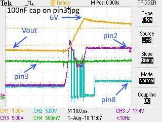

  • Here are scope captures of the waveforms showing the problem:
    Each picture is labelled to show the trace-color net signal matching.
    Yellow (Vout, 5V filtered output)
    Green (Vin, pin 2)
    Blue (SW, PH, pin 8, output drive)
    Pink shows pins 3 (EN), 4 (SS), 5 (VSENSE), and 6 (COMP)

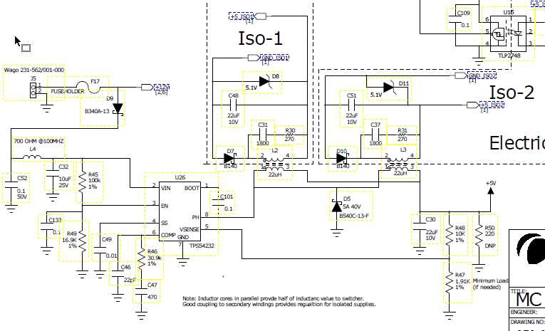

  • Here is the power supply schematic.  I think you can ignore the parallel dual-winding inductors, since they behave the same as a single 11uH inductor in this circuit.  The output does not always jump to 6.5V, but has to be carefully  teased to perform this action.  It occurs when the system is running and the power is momentarily disrupted (removed and then reapplied).  I do this bu wiggling the banana plug connecting the power to the power supply.  If the timing to provoke this behavior is important, I can rig up a calibrated interrupter and get that information.  You should be able to repeat the problem within a minute of connector teasing.  If you can't repeat it, can you send me a demo board and I'll return a modified system that will reliably repeat the problem.

  • My UVLO (enable) is currently set to 8.6V in this design. My compensation was taken from the results of my WEBENCH design work. Does this change any of your recommendations?

    Please remove C132, this capacitor will affect the UVLO, 0.1uF is too large. Because the input voltage changes too fast, the EN voltage will not drop to UVLO voltage.

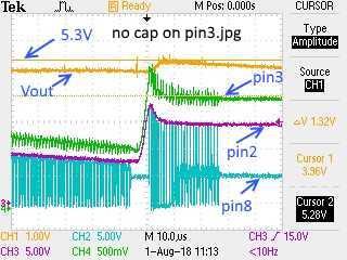

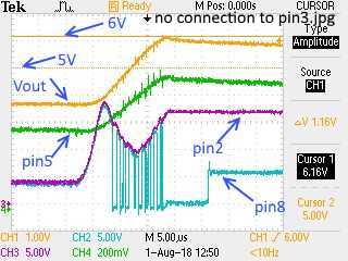

    I'm surprised that the VSENSE limit was not enforced during this EN/UVLO condition, since the datasheet (8.3.4) mentions that the EN pin can be left floating.  I've attached 3 screen shots showing the results of the recent experiments, including letting the EN pin float:
    The first one is my original overshoot with the 100nF cap on pin3.
    The second one is the same settings with the cap removed (much less overshoot).
    The third one shows pin3 floating (no cap on pin3), but still overshooting.
    You might want to add a caution about this condition in future versions of the manual.

    If you let the EN Pin float, the device will start up when Vin reach out to 4.2V, and shut down when Vin drop to 3.7V. So Vin is lower than 5V, the device will operate with 100% duty cycle. As I mentioned, if the Vin increase from this mode, the overshoot will be larger. what you need to do is preventing the device enter 100% duty cycle mode. So you need to set the UVLO voltage higher than 5V, so that the device will shut down when Vin is lower than 5V.
    In addition, from the waveform you captured, Vin changes too fast. I don't think the slew rate is large like this in the actual situation. Also, you can increase the input capacitance to lower the slew rate.
