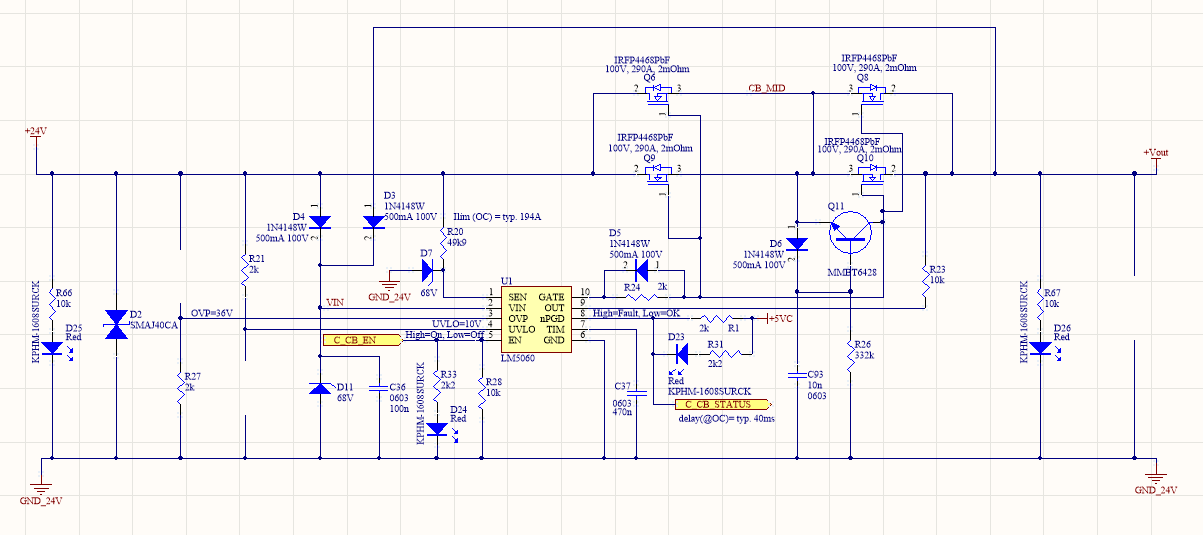

Hi TI E2E,
I use LM5060 at the output of my DC/DC converter. As the load will have either a battery or a load so I want protect converter against reverse polarity. I have a similar schematic to this from figure 41 from datasheet. Output voltage about 12V.  I have problem with turn on LM5060 when my coverter is working. But when I connect external supply to input LM5060 directly, it works properly. I tried to disable UVLO and OVP, change Rs and gate resistor. I do tests either with and without the output load. It very strange for me and I don't have any idea how to repair it. I have two IRFP4468 paralell because I have about 150A on the converter output. I check singnal on gate  and when I have external supply signals looks good, but when I turn on my dc/dc converter I don't have any signal. What should I check? Please give me some advice. Whether it can be related to the noise coming from the dc/dc converter?

    Can you share your complete schematic and test waveforms of LM5060. Please capture by disabling UVLO and OVP (for the time being)

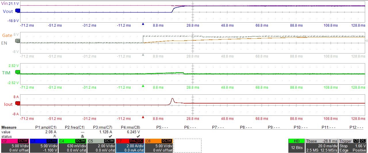

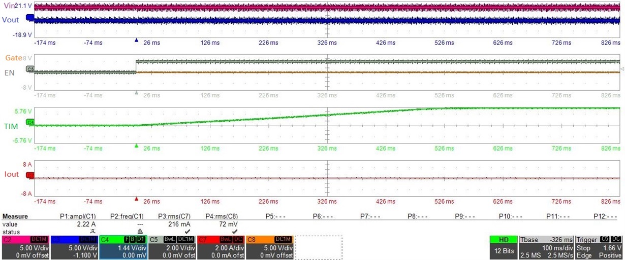

  • Signals with external supply

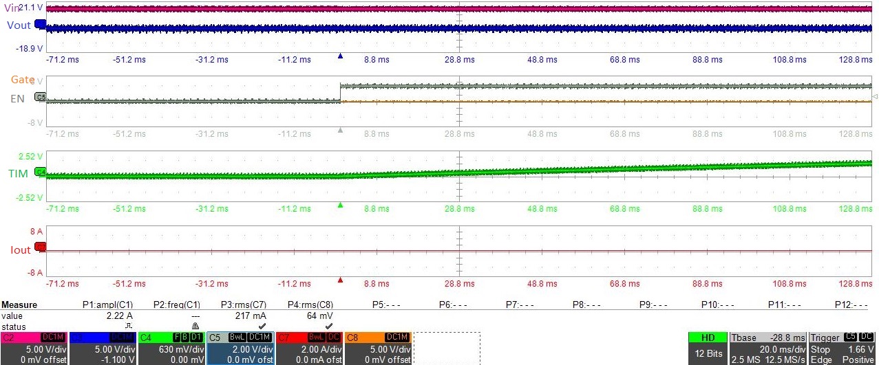

    Signals with dc/dc converter
    Thanks for the test waveforms. It is surprising that 'no GATE' voltage seen in the second case. There are no known issues with the noise for this device.
    What is the peak-peak ripple at the Vin (o/p of the dc/dc converter)? Can you please check by adding more decoupling capacitors to reduce the noise. If it is shareable, can you send schematic of dc/dc stage.
