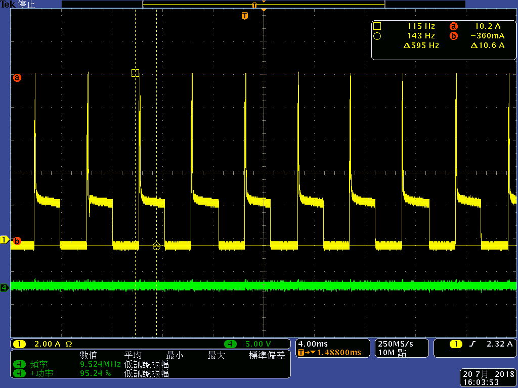

Hi Team
My customer use UDIM, output current has only peak 10A, not platform.
He wonder know why has only peak. is it been current limit.
Input=16V
Viadj=2.5V,
Rcs is 0.125 ohm
LED is 10A. 2 parallel, total output is 4.2V/20A,
  • Hello Bryan,
    Viadj = 2.5V means Vcs = 0.25V. If Rcs is 0.125 ohm current is 0.25V/0.125 ohm = 2A. I assume there is a large output capacitor on this design. That is probably what is causing the current peaking, recharge of the output capacitor. Rcs needs to be 0.0125 ohm for 20A when Iadj is 2.5V. Vcs is Viadj/10.
  • Hi Irwin
    Yes,it's 0.0125 ohm, it's my mistake.
    Increase output capacitor value whether improve this situation?
  • Hello Bryan,
    No, something else must be wrong.  If the regulation point is set to 20A and you see 2A then either the measurement is incorrect or something is not working correct.
    What is the power source to this?  Can you monitor the input voltage and see if it is stable or if the source is dropping?
    Can you run this without the PWM and see where it regulates steady state?
    Can you check the oscilloscope and make sure it is reading correct?
