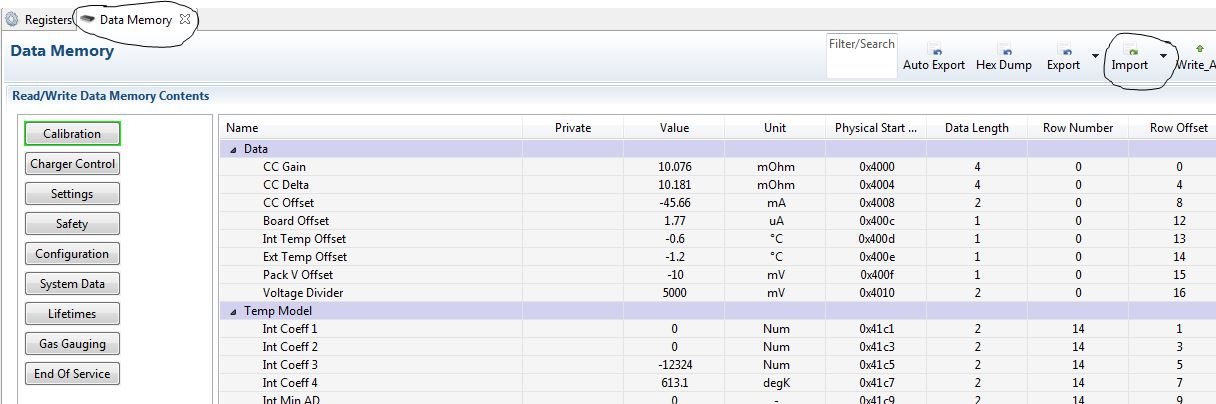

  • Hi, Matt.
    I have received my EV2400 and demo board. How do I upload this 10cell sample setting file into bqstudio please?
  • Hi Jin,
    In the Data Memory Plugin, there is a tab to import settings from a file. See the picture below.

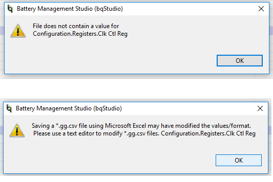

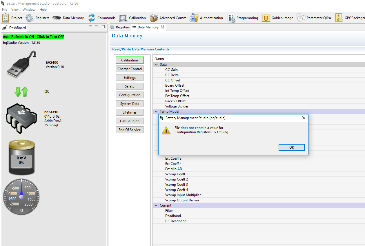

  • I have got this error message. Does it matter?
  • I did export the current one into a file, then import it. It shows no error message.
  • Did you open the .gg file in Excel and save it? Excel will change the format, so you may want to download the file again.
    Also, make sure you are using the latest version of the firmware and bqz file. In the Dashboard on the left side of the screen, it should say 0110_0_02 for the version.
    Matt

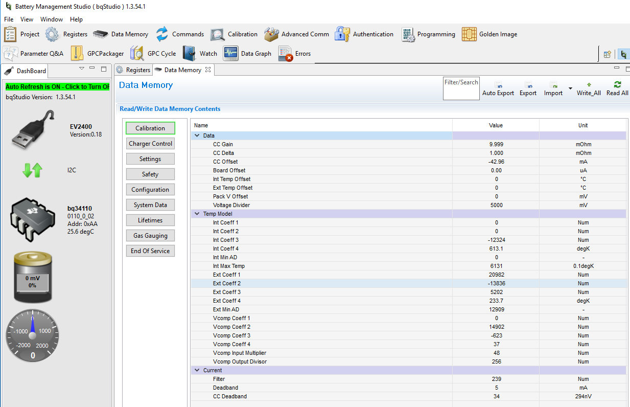

  • No, I did not open with excel. I try to download a new one as well. Still gives that error message.
  • Jin,
    I think I see one issue. You will need to download the newer version of bqStudio (under BQSTUIOTEST) at www.ti.com/.../bqstudio.
    This will soon be released as the production version, but I think this may resolve the issue.
    Matt
  • sorry, still got this error with new version bqstudio
  • Hi Jin,
    Hmm, that's very strange. The register it is giving an error for is a reserved register. It is okay to ignore this error as long as the other settings are getting loaded to the Data Memory.
    Matt

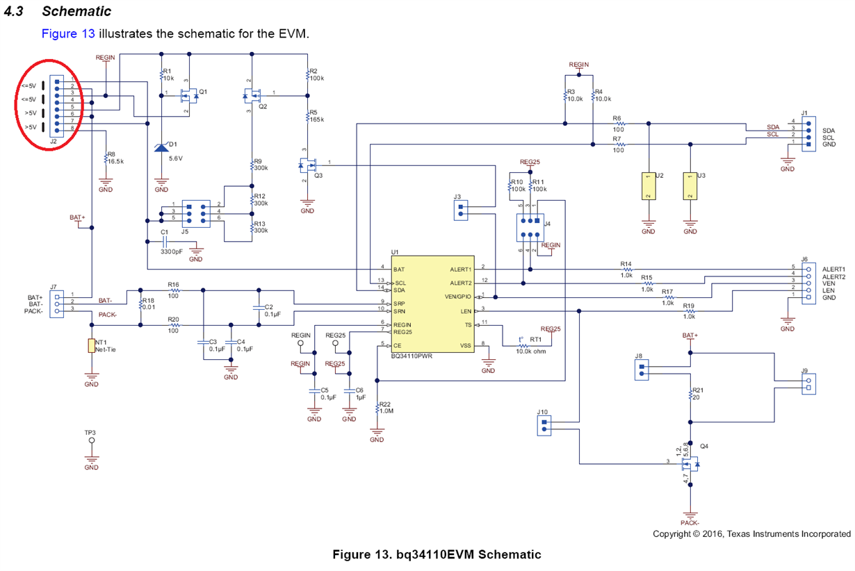

    I am always getting voltage reading 0V. I checked the schematic of BQ34110 demo board. If I put two jumpers on ">5V" two positions. REGIN should have a voltage, but clearly "BAT" pin of bq34110 has got no voltage at all. Is my two jumpers at wrong positions? Or the demo board is wrong?
  • You also need a jumper on J5.
  • Hi Jin,
    Have you enabled the VEN pin in Data Flash (this will cause the VEN pin to pulse to enable the external voltage divider during voltage measurements). It is also important to set the voltage divider and run calibration on the voltage measurement. See if the steps below help to fix the voltage measurement. I am in the process of updating the EVM User Guide, so it would be good to see if these instructions are clear enough. (I am assuming you have a jumper in place on J5 and J3).
    For packs where the stack voltage is greater than 5 V:
    • Enable Calibration Mode on the device by pressing the CAL_TOGGLE button on the Commands panel. Verify that the CAL_EN flag is set in the Manufacturing Status register.
    • Update the Flash Update OK Voltage parameter on the Data Memory Configuration screen to 100mV (default is 2.8V). This parameter prevents flash updates when the measured voltage is below this setting.
    • Set the VEN_EN bit to “1” in the Pin Control Config in Data Memory on the Settings screen. This enables the external voltage divider on the EVM and disables the internal voltage divider.
    • Set the Number of Series Cells parameter to the appropriate value on the Data Memory Configuration screen.
    • Set the Voltage Divider parameter in Data Memory on the Calibration screen. This value should be set based on the external resistor divider setting. (For example, use ~19,200 when the J5 header is set to the 16V setting which divides the BAT+ voltage by 19.2).
    • Reset the gauge using the RESET button on the Commands panel.
    • Calibrate the stack voltage. (see calibration instructions in EVM User Guide).
    Matt
  • I did put a jumper at 16V. Is that right?
  • Yes, a jumper at the 16V setting is correct.
