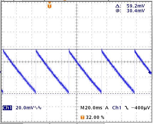

At higher load the ripple is lower compared with light loads or no load. The picture below shows the ripple without a load (this is a +5V supply for external devices). In that case I get a relative high ripple of 59mV at a very low frequency (42 msec). However of course this is not a practical use because normally there will be always a load when using this supply.

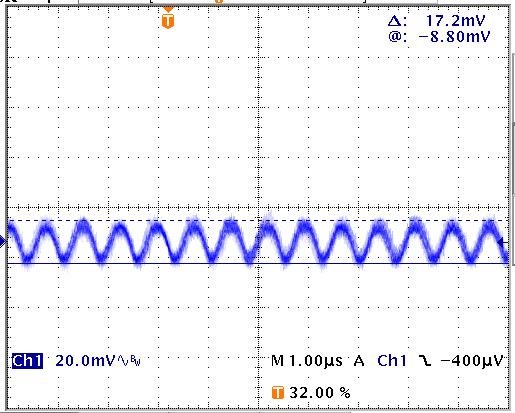

When I put a (resistive) load of 1A the ripple is reduced to 17mV at a frequency around 1.3MHz (I think due to the fact that we connected the FSW input with the voltage output of the converter.

So my question is if this looks normal and is it normal that the amount of ripple depends on the load? And is it normal that a relative high ripple a low frequency (first picture) is measured at the output when there is no load at all?

  • I think what you see is normal operation. At light load the device maintains the output voltage with single pulses (datasheet section 9.3.2, Power Save Mode).
    Figure 30 in the datasheet shows how the switching frequency gets lower at lower output current and Figure 36 shows waveforms at low output currents (10mA in this example). If you further decrease the load the switching frequency further decreases. In your case you have a switching frequency of 25Hz. The ripple in this mode of operation basically is defined by the output filter, mainly the capacitance you have at the output. If you increase the capacitance the ripple should become lower, just make sure that you stay within the recommended output capacitance value range (datasheet table 3).
