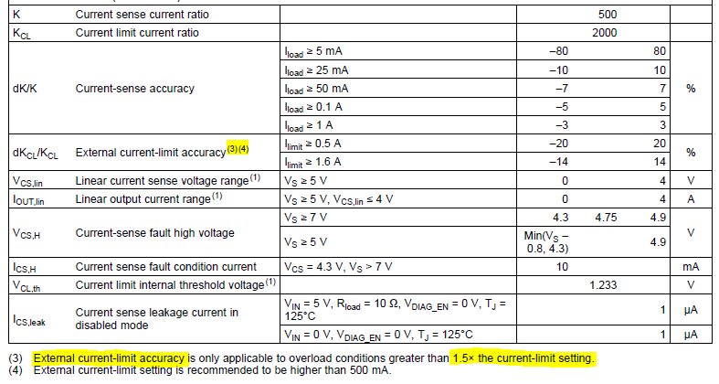

Team,
What does the foot note on page 7 mean?
If current limit is set to 1A, then the accuracy shown above is defined at 1.5A?
