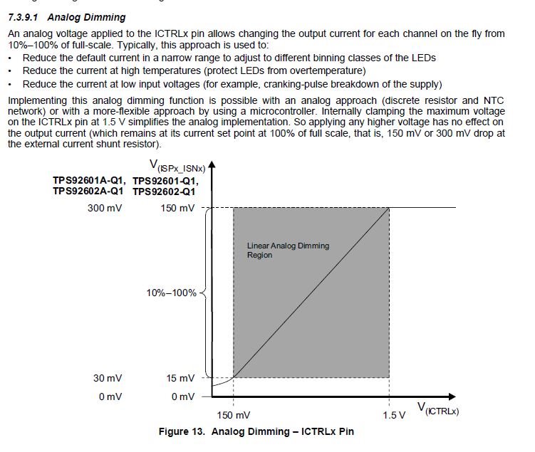

Dear all,
Is there experience of current control with temperature?
My customer concern temperature.
To protect around devices from over heating, my customer think to use thermistor to current control to limit current as heating.
If you have experience to use thermistor, could you teach us how to use this and circuit diagram?
Or could you teach us how to design to satisfy this requirement?
