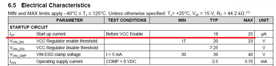

Hi team,
my customer is using LM5022 to design an offline flyback converter. They want to know what is the startup current for LM5022? They need to calculate required startup current and HV startup resistor value.
Thanks.
Wei-Hao
  • Hi Weihao,
    What do you mean by start up current? And what is HV startup resistor? If you mean the inrush current, it is determined by the input capacitor, output capacitor, transformer, soft-start capacitor, and the load tied to the output during startup. The LM5022 controls the SS to limit the inrush, but mostly it is the external circuit design, not the LM5022 itself.
    Youhao

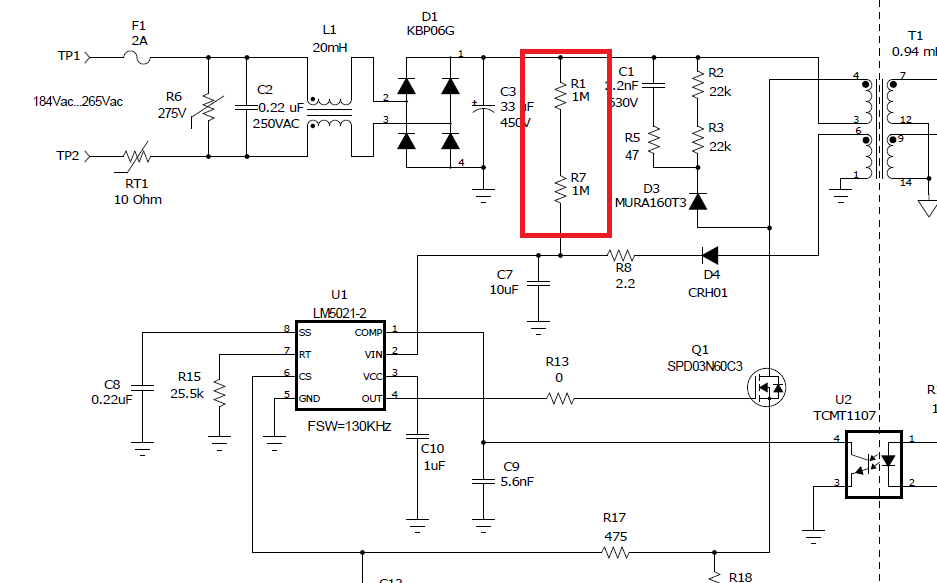

  • Hi Youhao,
    The required current for the controller when VIN is below UVLO. For the offline isolated DC/DC converter, controller needs draw current directly from the HV line, it needs HV resistor to limit the current to charge the VIN cap and supply the current to controller.
    Please refer to LM5021 as a example:
    This current will determine how big of the HV startup resistor can be used.
    Thank you.
    Wei-Hao
