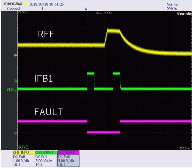

We have a problem when it startup. Please see the following waveform.
When we start up the device on the customer board but Vout does not goes up correctly. We repeat the startup then it operate finally normally.
When it does not startup, the FAULT signal become high.(Please see below)
Have you ever see this phenomenon before? Could you provide us the any causes which is possibility?

  • Hi Hamamoto-san,
    From the screenshot, it looks like the device hit the IFBx OVP after unused detection. what is the FBV voltage setting in customer design? what is the resistor connected from IFBx to GND in all the channels? Are all channels used?

  • Hi Caryss-san,
    I have one more question.
    As you can see at the above waveform, IFB waveform looks the open detection operated twice. Is this behavior correct?
    Koji Hamamoto
  • Hi Hamamoto-san,
    The open detection doesn't operated twice, the first one should be unused pin detection, the second one look like IFB ovp.

  • Hi
    The customer confirmed IFBx pin voltage as you mentioned, however it was not reached the IFB OVP threshold (38V).
    (IFB6 is connected to ground via 22k resistor because of not used.)
    What do you think?
