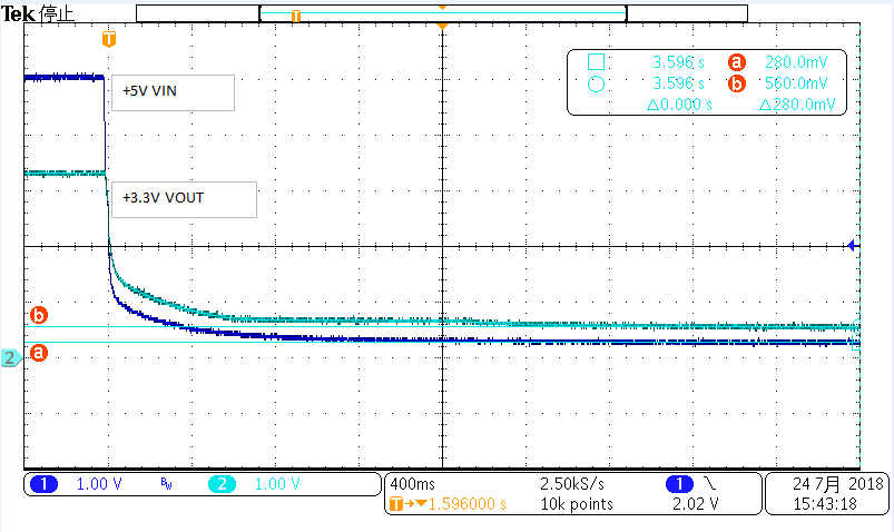

SW pin of absolute maximum rating is specified "VIN+0.3V".
Vsw overs VIN due to the large output capacitor  when VIN drops as below.
Then, voltage difference during Vsw and Vin is about 0.3V.
Is this condition problem?
I guess that this is no problem because this 0.3V is generated by body diode of high-side FET.
