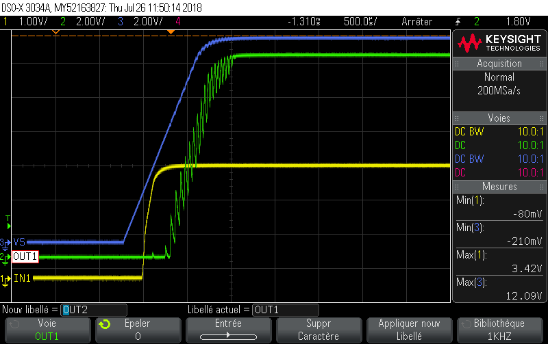

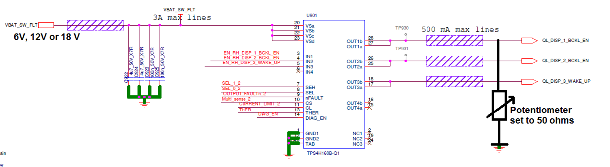

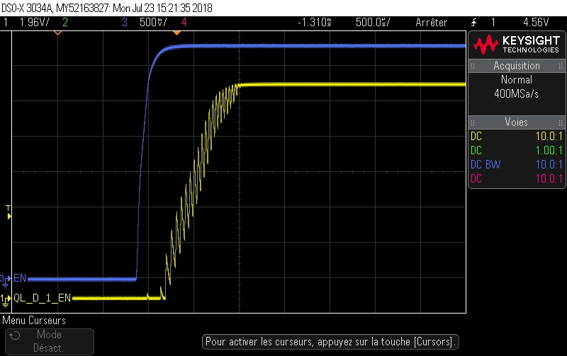

I've got a problem with the TPS4H160B-Q1 chip. Please find attached the curves showing IN1 (blue) and OUT1B/A (yellow) signals.
- VSa/b/c/d = 12 V
- IN1 = 3.3 V
- A potentiometer set tp 50 ohms is connected to the load (current limit is set to 425 mA)
Thanks for your help,
Mickaël.
