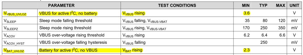

I understand that VBUS or VBAT need to decrease below than each UVLO threshold to hardware reset. Then how long time it should keep blow than ULVO threshold to reset all the registers?
