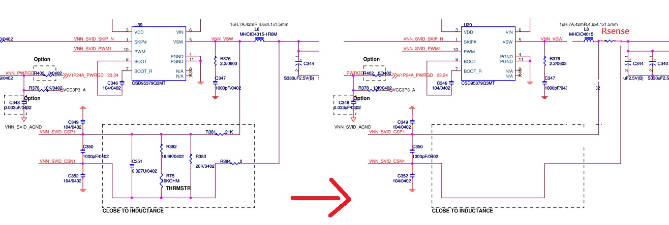

Based on the Excel calculation, here's some question:
1. where's the I_TDC in intel's spec?
For example, the power VNN in spec, our customer can only find the maximum current is 3.5A, and the I_TDC does affect the result of DCR pass or fail.
Or how do you recommend to decide the I_TDC based on the maximum current?
2. Can I set I_TDC lower if I can keep the heat away?
3. In the datasheet of TPS51623, there are 2 way to sense current-inductor DCR sensing or resistor current sensing.
Is there any reference circuit and calculation about resistor current sensing?
4. If end-product has size limitation, so can't chose low DCR inductor. Is it ok to use resistor current sensing?
