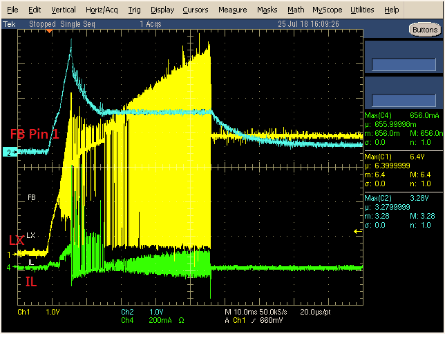

our client use TPS65150-Q1, but we find Power on 47ms, SW waveform was stop.
it`s could be UVLO protect.? or other effect?
We measurement L1 current and Voltage and FB Pin1 Voltage as below chart:

  • Hello Lawrence,
    The TPS65150-Q1 device detects a fault condition and shuts down if the boost converter output or either of the
    charge pump outputs fall out of regulation for longer than the fault delay time td(FDLY). Furthermore, the output fault detection function is active during start-up, so the device shuts down if any of its outputs fail to reach their set regulated output level during start-up.
    I am thinking that your customer may have set the DLY1 and DLY2 delays such that negative and positive charge pumps take longer to come up than the fault delay (FDLY) time and that is probably why the device is shutting down since not all outputs have achieved regulation by the time FDLY time expires i.e. the FDLY time expires before all three outputs are fully up and hence the device shuts down.

  • Hi, Liaqat
     Thank you! we find the probleam ,our client confirm is FDLY time expires so device was shuts down.
