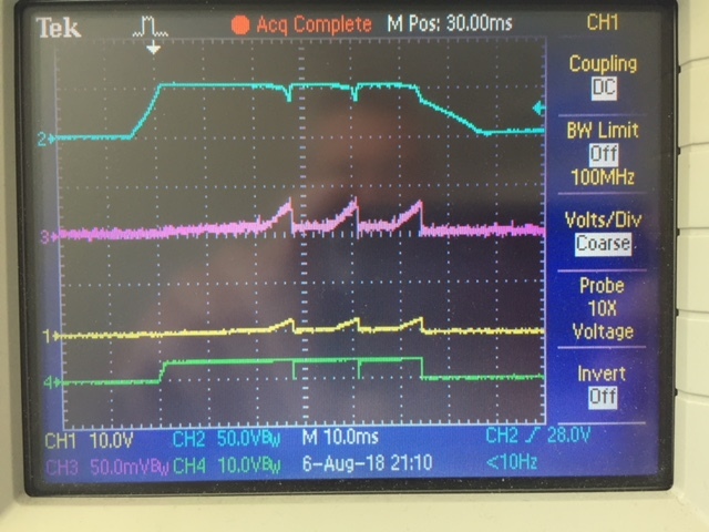

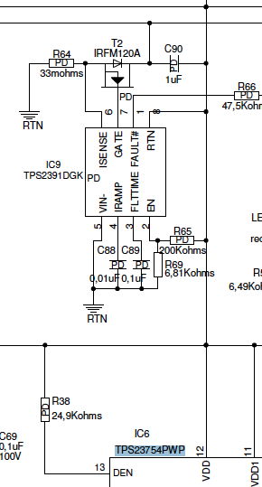

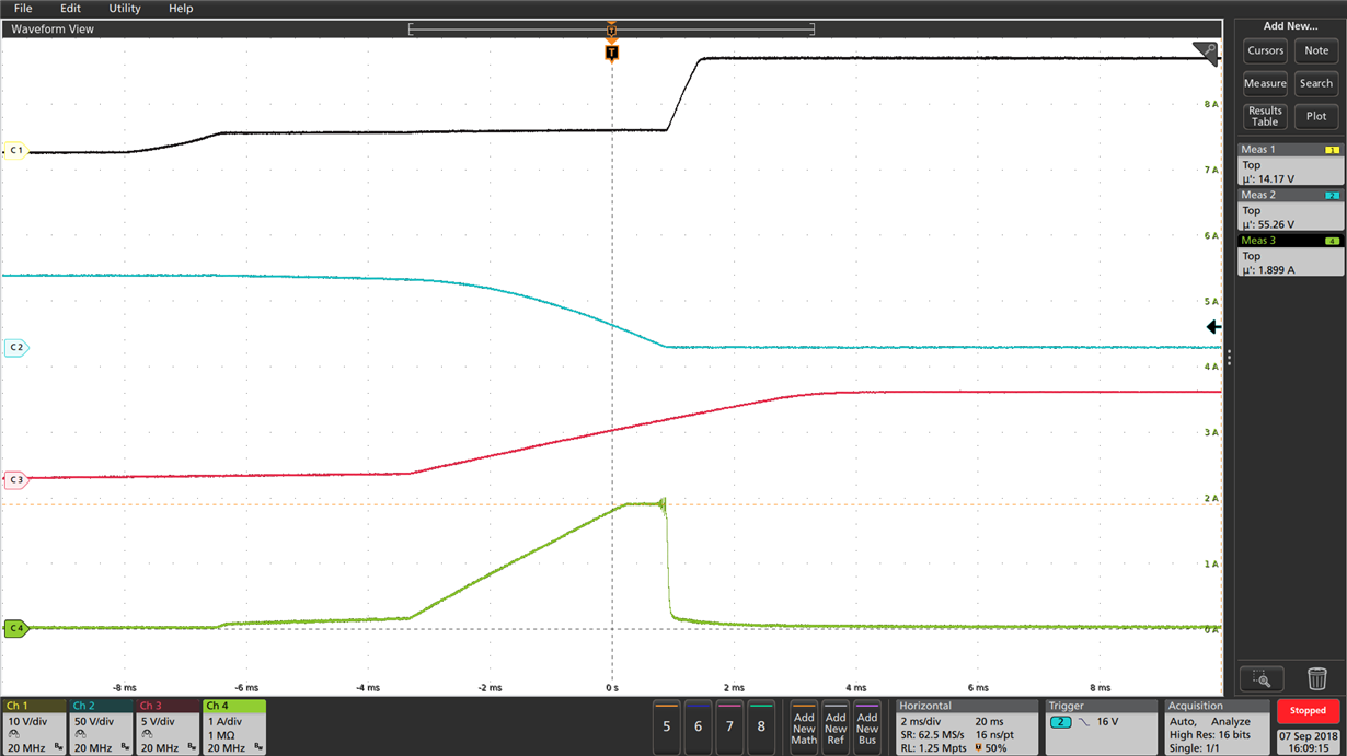

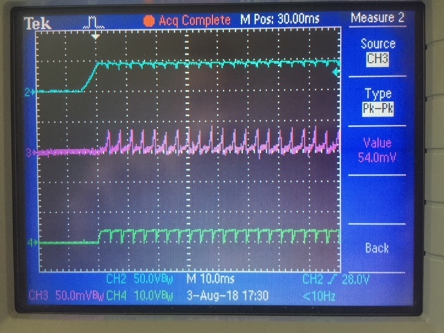

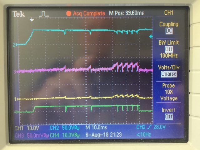

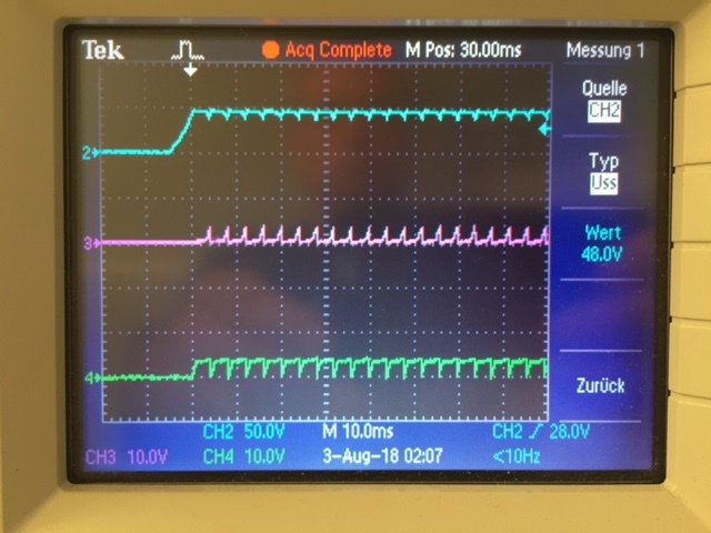

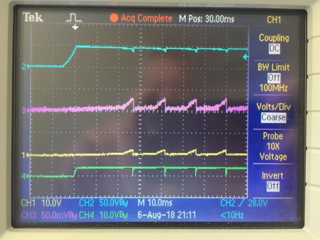

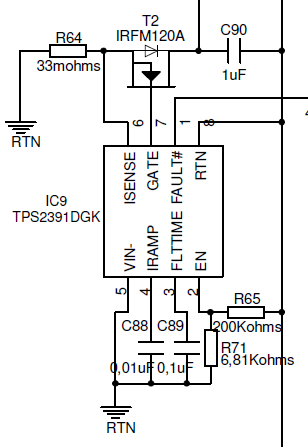

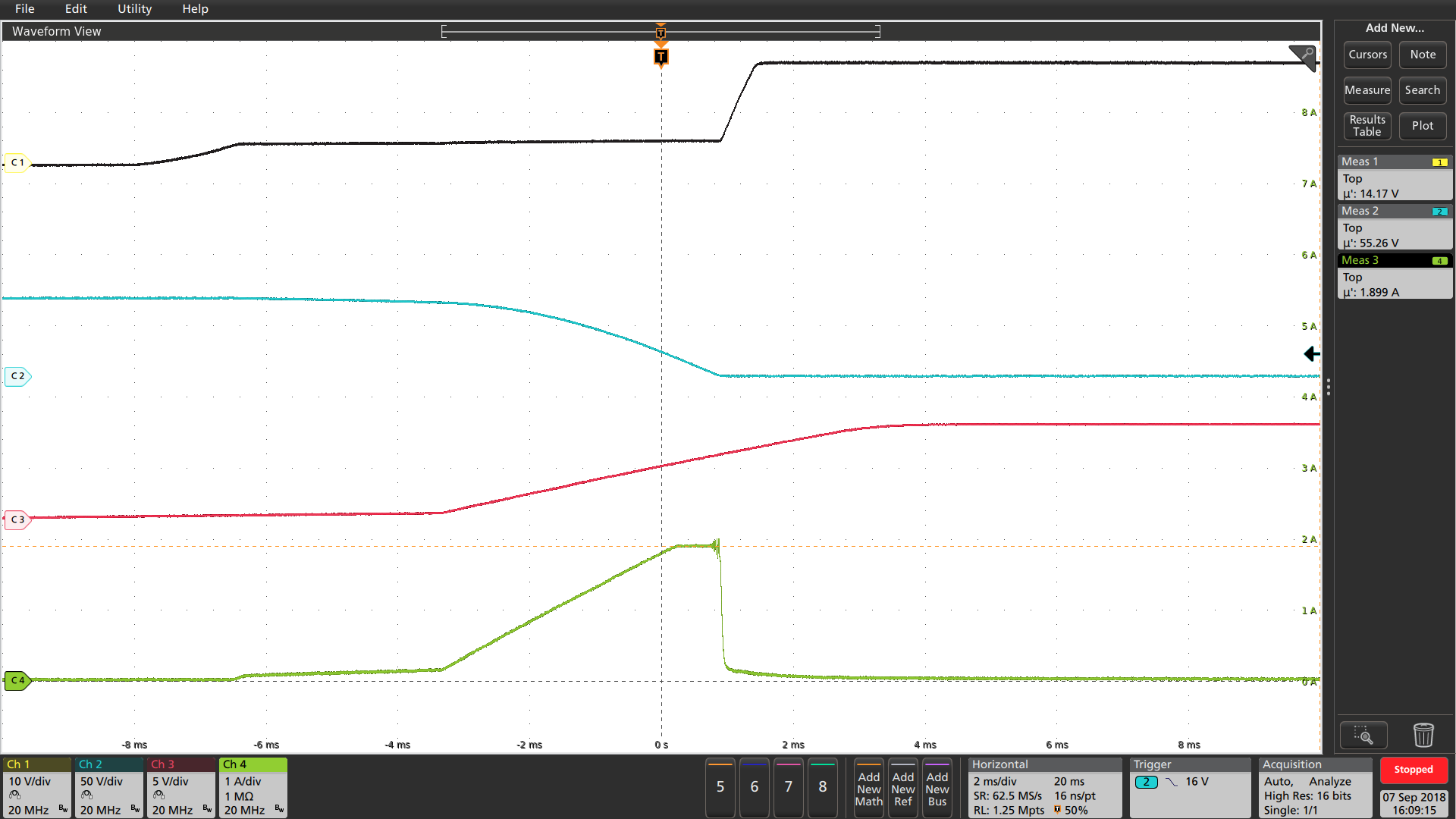

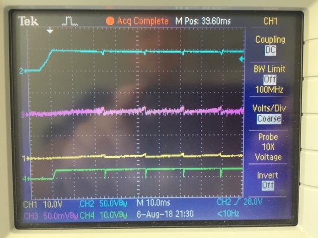

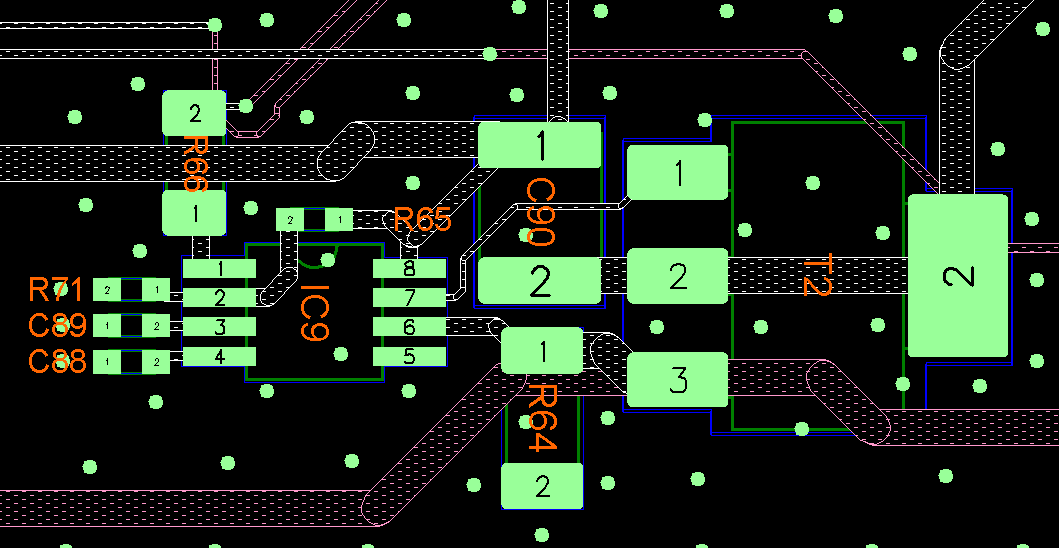

We are using the TPS23754 PD-controller. As soon as the switch provides power, we want to forward the PoE-rail voltage using the tps2391 hot-swap controller.

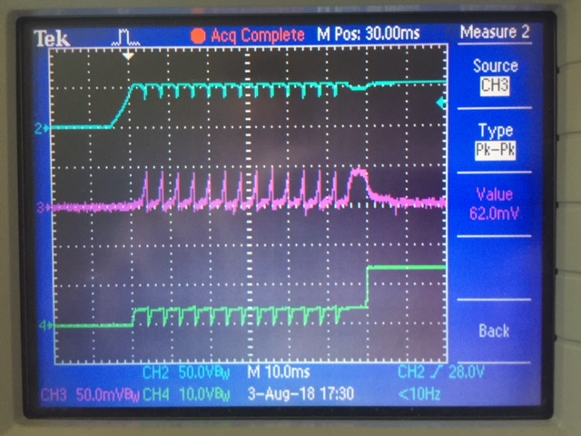

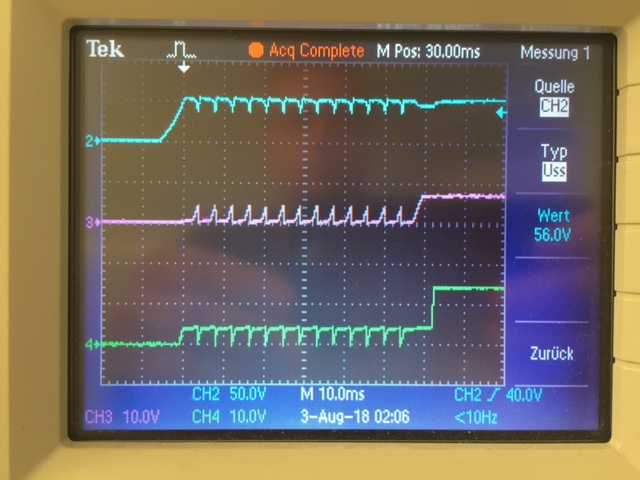

This works for PoEplus fine. But for standard PoE we get a fast on/off switching of the tps2391 and the MOSFET T2 overheats. Any suggestions?
