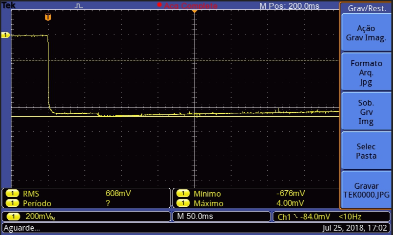

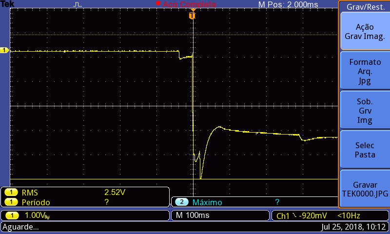

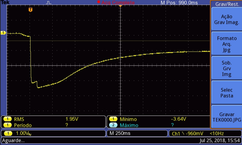

In the case below, we show a measurement made between VC10x-VC15 during the connection of the first cells (C1-C5) without the presence of bq76940:
It’s worth mentioning that we don’t know if this negative voltage is the cause of the problem.
How can we solve this problem? What would be the suggestion to work around this?

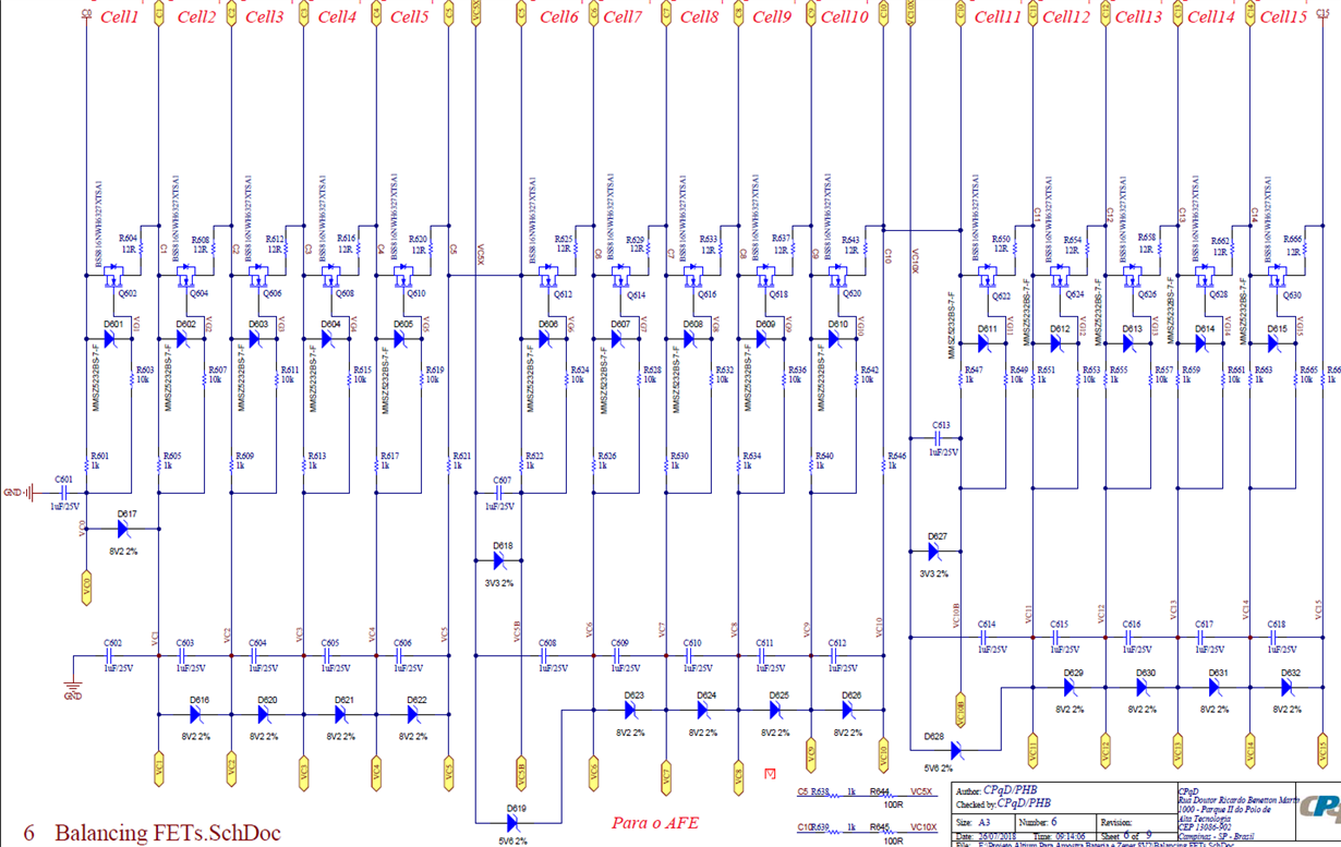

Attached is the schematic of our BMS.

    I don't see a problem from the schematic. The schematic looks very much like the EVM which worked, so your board would be expected to work also.
    It seems odd the waveform is so fast to fall. There are a lot of series capacitors pushing up VC15, they are in series , but the balance FET capacitance and 12 ohm resistors are also pushing up the unconnected cell inputs, and the power filter caps C701 and C713 should also be pushing up C15. With the bq76940 in the circuit there is an effective diode from VC10X to VC15, so -3V would not be tolerated well. The diode would conduct, current is limited by external components, but if the board is forcing that voltage the part may not survive. The circuit is expected to take an ESD event rather than sustained current.

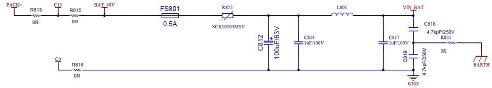

    The connection of C0 to GND is not shown on the schematic pages. Since VSS is the reference for the IC GND is recommended first.

    How is the cell 0 connected to GND?
    C0 and GND are connected as shown below:

    We got two different results measuring between VC10x-VC15. First, the bq76940 was not welded to the PCB:
    Second, bq76940 welded to the PCB. Here we can see the internal diode acting.
    In order to protect the filter capacitors and the inputs, we placed zener diodes to each input as shown below:
