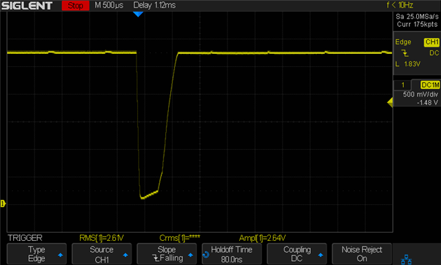

Situation is as following, the Overvoltage is set to 13,55V I increase input voltage to 13,6V, the output MOSFET is switched off. Input voltage goes back to 12,5V
Now I am pulling down EN/UVLO pin and  VREG for a 100us. And the output FET is not activating. I have designed on my board the reset circuit based on that what stays in the datasheet point:

So now after what I see for me the VDD pin should be pulled down not the VREG, maybe VREG only if you need chane or reassign the I2c address. I have looked on the scope at the VREG pin, it was 0,5 V for more than 300us, during the first 100us the Vreg cap is discharging linear down to 0,5V.
Is this a failoure in the datasheet or am I missing something?. Simple, The circuit is no starting on after Overvoltage has occured, even after proper resetting, regarding to the datasheet.

  • This was done on my board, i will try to reproduce that on EVM.
    I am giving back honor to Ti  on EVM it works ok, after overvoltage event as soon as the voltage goes back to the nominal level  the output is self activated, even without resetting the LM.

    I have relative High Ohmic resistors setting the OVP and the hysteresis is very wide, the positive threshold is about 15V and negative about 8.5V.
    Does the circuit after over voltage event must go bellow negative threshold to activate the output? or when the VREF and EN/UVLO is pulled down it is does not matter. For example.
    Over voltage hysteresis is set as following
    OVP+15V
    OVP-8.5V
    now I set input voltage to 16V and output is switching off.
    Input voltage goes back to 12V.
    Should the circuit activate the output after releasing VREF/ EN/UVLO from GND?
    Or it must goes bellow the negative threshold point?
    This is VREF pin and after this the output was not activated. The procedure was so:
    VIN, 12V, outpout ON ,
    Vin=16V, output off (OK),
    VIN back to 12V,
    VREF to GND and the output still off (WRONG) . VIN did not go bellow 8.5 (Lower OVP treshold)
    This is VREF pin.
  • Hi Christopher,
    The overvoltage event switches OFF the system but does not latch-off the device. The device resumes operation when the Vin is reduced below the OVP- threshold.
    Q) Should the circuit activate the output after releasing VREF/ EN/UVLO from GND?
    A) the device can be reset with VDD or Vin power cycle.
    Rakesh
