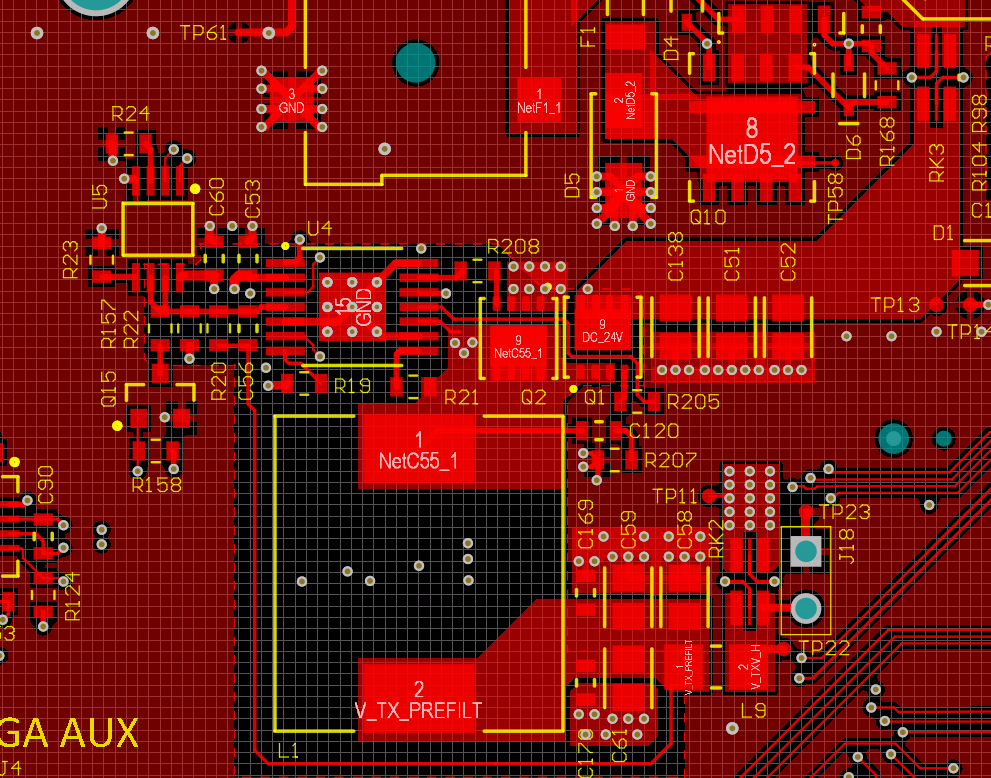

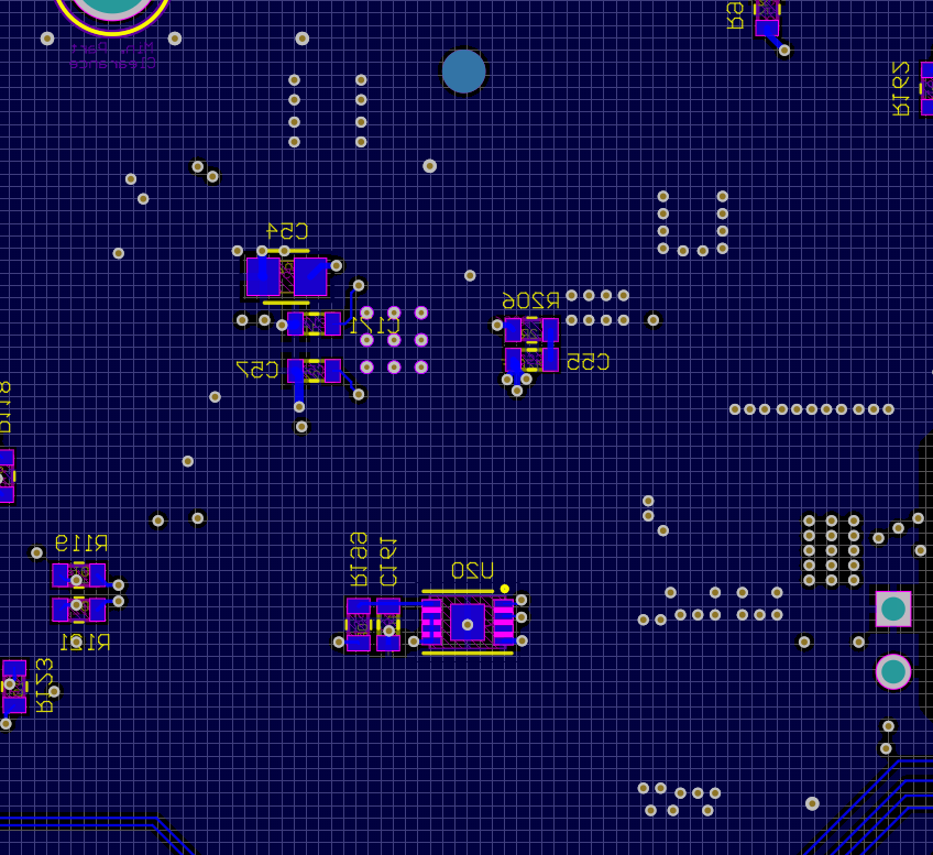

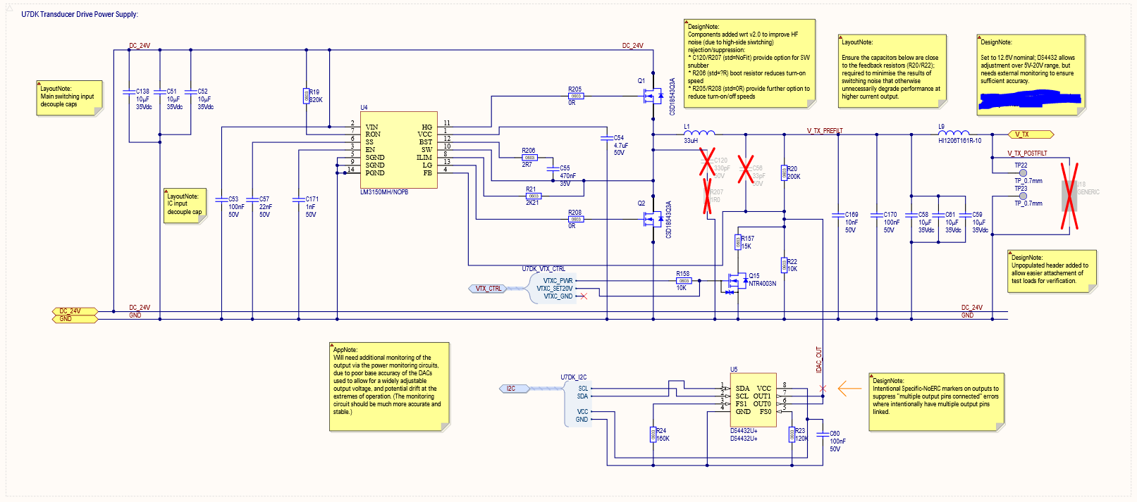

  • Hello David,
    U5 is a current DAC that isn't used at preset, it's output leakage current is +-1uA when programmed for zero current.
    Topside PCB layout:
    Bottom side PCB layout:
    Many Thanks,
    Oliver
  • Thanks for sharing the schematic Oliver,
    I think the layout may have something to do with your failure issue.  2 layer boards are a little more difficult to do than 4 and can give rise to cross conduction of the MOSFETs if the PGnd is not tied back to the low side FET with a low impedance path.
    Please see below suggest floor plan.  Suggest you hack the board to suit and retest.
    Hope this helps?
    David
