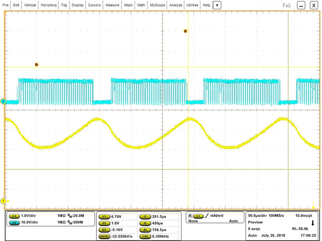

One of the outputs of TPS5130 sometimes oscillates at ~6.4kHz on power on. This instability seems to disappear by increasing C2 from 1800pF to 1950pF. Easier way to help me would be that I send you the configuration files from TI, screenshots of the output and schematic.

    I added just after my first post some details about the design:
    1/ TPS5130_DIMENSIONNING_3V3.xls: This file has been downloaded from TI TPS5130 page. In in are all the details about output characteristics.
    2/ First picture: in yellow, you have the +3V3 output when oscillating (not systematic) and in blue, the control of the mos connected to Vin (+5V)
    3/ Second picture: Same as picture 1 with a zoom showing that duty cycle on control is always maximal
    4/ Our schematic about TPS5130 connexions.
    In response to your question, yes, only one channel (n°3) has this kind of behavior. The two others (1 and 2) are not affected and the control seems fine (in not periodically stopped like ch3). So refering to picture on page 9 of datasheet, control interruption seems not linked to OVP or UVP (Fault stop from OVP is common to the 3 channels). Input voltage is +5V and output current is 0.5A max.

    i think the reason is the loop issue. can you test bode plot? if not, can you test load transient and upload the waveform?
    You also mention that it's ok when C2 changes to 1950pF. it's suggested to use 2000pF cap for C2.

    I placed 2200pF for C2. I can see on scope that oscillation sometimes starts on output increase but stops systematically.
