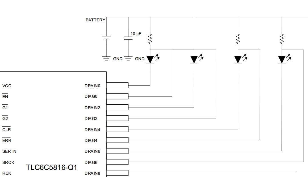

Hello TI,
May know TLC6C5816-Q1 output can parallel from same BAT and resistor?
  • No recommend to , as it is not a constant current device ,RDSON variation may result in the channel overcurrent which may damage the device.
    May I know the application? We have TLC6C5724-Q1 this kind of constant current device, you can parallel output channels for large output current.
