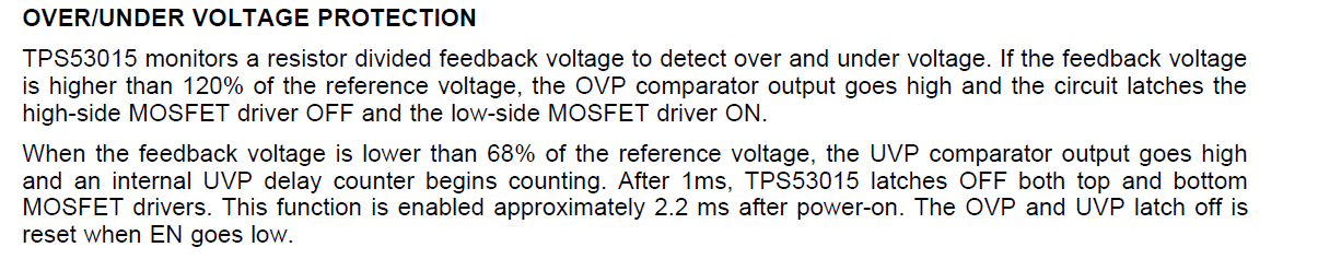

Hi team,
You know our datasheet says, the device TPS53015 will respond UVP after 2.2ms and 1ms will latch.
so if we short the output before enable, what;s the turn on time? it's 2.2ms or 3.2ms. Thanks.
