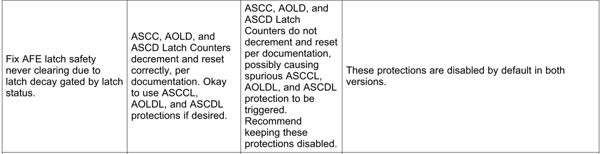

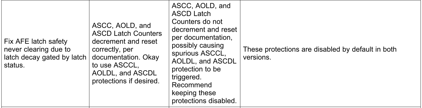

In the SLUUBS8 User's Guide, it highlights the ASCD latch counter bug, and in the SLUA880A Application Report, the change details said fixed AFE latch safety bug.

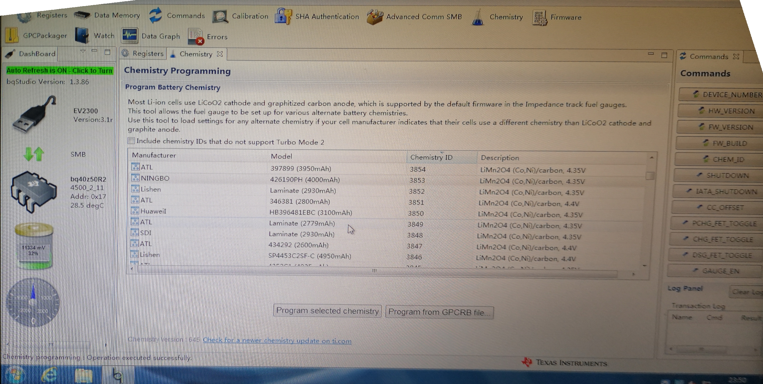

But after i update the firmware version from 1.06 to 2.11, find that it still have the latch counter bug. Then i degrade the firmware version to 1.06 or use the original version 1.06 ICs, they all have the bug not fixed.
Because i just have the ICs original firmware version 1.06, please help me check that whether just the original shipping with v2.11 pre-programmed ICs can use ASCDL protection.
