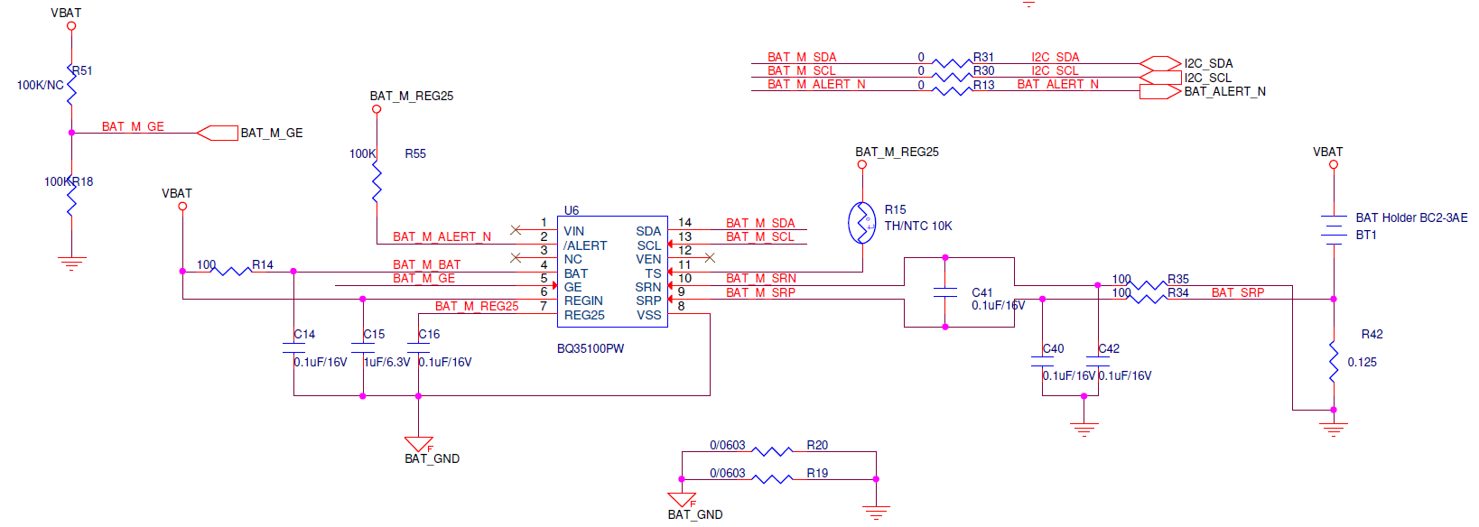

Hi Team,
One quick question, if coin cell is not install, so VBAT has no voltage. If MCU sets a HIGH to GE pin, will we see 2.5V happen at VBAT pin below?
If yes, can I understand how it happen? Thanks.

Hi Onyx
Yes, when customer removed the device or Set GE pin as open-drain, VBAT will no longer shows 2.5V. So I just want to find the root cause and close this case, If it sounds reasonable to you ?
Thanks.
